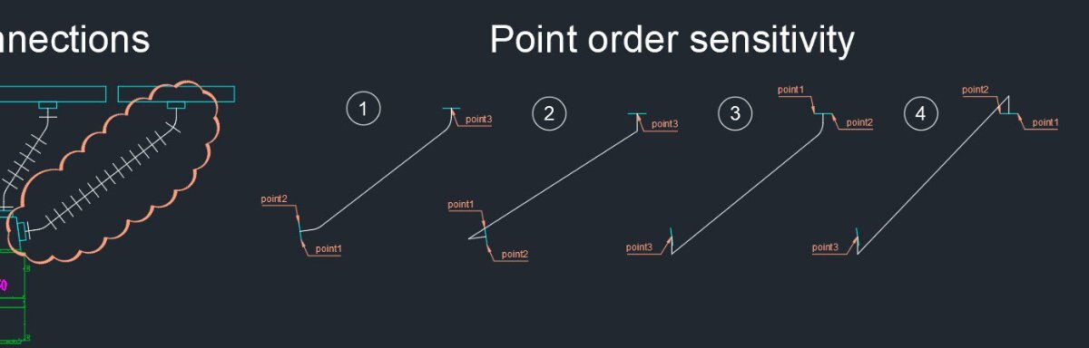

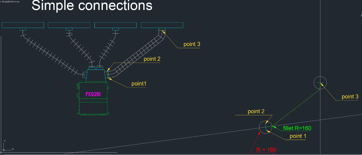

Hey, that's a fun problem to try to solve.
I got part of the solution.
- Command DFT (for Draw Flexible Tube)
- Select point 1
- Select point 2
- Select point 3
... as shown on the picture

Perfect, effective wrapping code. Much, much better than what I actually use.
But my goal is to draw a centreline (polyline) to connect necks or flanges much more efficiently without using auxiliary lines.
Especially when the flanges are rotated against the ortho system.
My code draws the center line.
Tharwat's code wraps it.
My code should just polyline edit -> join them

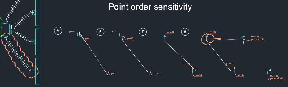

It works fine but it is very sensitive to the order of the points as you can see in the attachments and I never know what order to choose to get the right result :)
And in case number 8, the line created is not perpendicular.
Flexible ducts.dwg
Yeah, as your example showed, my code assumed a vertical ending.
I'll adapt it for different angles.
And yes, it asks for an order of points.  First right edge, then left edge.
Right and left are defined as: point 1 is right, point 2 is left.
Take a line p1-p2.  Now that angle based of the line, turn it 90° clockwise.  In that angle the duct will go away from the base

If you can get used of the Right-Left definition, then use this.  It now does any angle
(again: line from right to left, add 90 ° clockwise, that's the direction of the tube/duct)
EDIT:
- Oh yes, and I join the lines and arcs to 1 polyline.
- And I set it to the right layer, color, linetype and lt scale
Then you can use Tharwat's code to make the wrapping

	;;(setq p3 (getpoint "\nPoint 3: (middle of the top): "))
	;; step 1, we need a point perpendicular to p1-p2, length = distance p1-p2
	(setq kink1 (polar pm ang1 duct_diam))
	;; dito for endpoint.  I assume the top is always horizontal
	(setq kink2 (polar p3 ang2 duct_diam))
	;; We draw 3 lines.
	(setq pl1 (drawLine pm kink1))
	(setq pl2 (drawLine kink1 kink2))
	(setq pl3 (drawLine kink2 p3))
	;; now fillet
	(setvar "FILLETRAD" duct_diam)
	(command "_.fillet" pl2 pl1)
	(setq fillet1 (entlast))
	(command "_.fillet" pl2 pl3)
	(setq fillet2 (entlast))
	;; Now we'll join these lines and arcs to 1 polyline.  We first put them in a ss selection
	(setq duct (ssadd))
	(ssadd pl1 		duct)
	(ssadd fillet1 	duct)
	(ssadd pl2 		duct)
	(ssadd fillet2 	duct)
	(ssadd pl3 		duct)
	(setq duct (pj duct))
	;; linetype and scale
	(setq obj (vlax-ename->vla-object duct))
	(vla-put-layer obj "MF_Flexo")
	(vla-put-color obj 7)		;; 7 = white
	(vla-put-linetype obj "TRACKS")
	(vla-put-linetypescale obj 320)
Great,
It works exactly as expected.
I don't want to be ungrateful, but couldn't it be made more efficient by not entering points, but selecting a line (flange), calculating the centre of the line, the length of the line (duct_diam), then the normal vector to the line and the coordinates of the point lying on the normal duct_diam away, (there will be 2 points on each side :)), the same for the other flange and then find out which normals intersect and that will indicate the direction of drawing the axis of the pipe.
It would be 2 clicks instead of 4 :)
Of course, I don't want to waste your time, and the code you already sent me will save me a lot of time anyway.
Thank you very much
Right now the flanges are not lines.
They're blocks.
So it's selecting a vertex of the polyline inside a block
I'll need to extend this code I wrote a while ago.  It will takes some time
They're blocks.
Yes, you're right.
That would be my next question, how to select part of the polyline and also inside the block :)
Yep nentsel will find a pline in a block. Then can work out which segment, then in turn 90 angle and midpoint. (cadr (nentsel)) is pick point.
(entget (car (nentsel)))
Select entity: ((-1 . <Entity name: 62ba0840>) (0 . "LWPOLYLINE")
