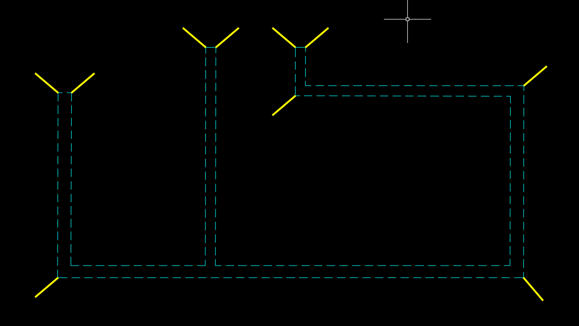

Here is my take, with visual lisp.
Corrected the code to work for cw and ccw poly, and attached the file.
;; markpl      by ymg                                              ;;
;; From a selection set of polyline the app will                   ;;
;; draw line 50 units long to the outside of each concave angle    ;;
;; of the closed polylines in the selection set.                   ;;
;; Requires iscw_p by Lee Mac                                      ;;

;; http://www.lee-mac.com/mathematicalfunctions.html               ;;
(defun iscw_p (lst)
  (minusp
    (apply '+
	   (mapcar
	     (function
	       (lambda (a b)
		 (- (* (car b) (cadr a)) (* (car a) (cadr b)))
	     lst
	     (cons (last lst) lst)
markpl.lsp
Edited by ymg3
typo
