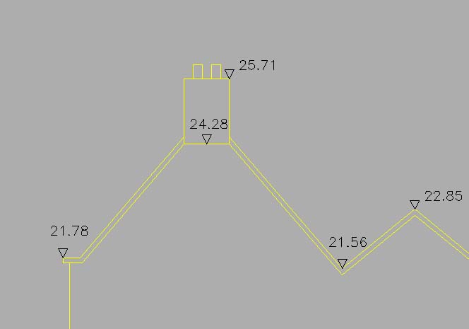

coombsie11 Posted February 26, 2009 Posted February 26, 2009 Hello. I am looking for a lisp routine that will make adding levels to section drawings much easier. I know that they exist, as I have come across one in the past. Once I have set a datum to a specific level, using the UCS in AutoCad I would then like to - select/id a point, endp or nearest and have a predefined arrow block inserted at this point, with the Y value (level) given in predefined text next to it. Text and block in layer "LEVELS". Its obviously so much quicker than IDing a point and then hand typing the text after and it eliminates user error too. Can anyone help me please? Quote
uddfl Posted February 26, 2009 Posted February 26, 2009 Why not use ordinate dimensions? But here, have this LISP. It does not insert blocks but it's for updating existing text/blocks. Still pretty useful and can be easily extended to suit your exact needs. (defun c:ue (); update elevation text (setq prev-osm (getvar "osmode")) (setq ypoint (cadr (getpoint "\nSpecify reference point for elevation: "))) (setq entname (car (nentsel))) (setq entlist (entget entname)) (setq entlist (subst (cons 1 (rtos ypoint)) (assoc 1 entlist) entlist)) (entupd entname) (entmod entlist) (princ) ) Quote
Lee Mac Posted February 26, 2009 Posted February 26, 2009 Yes, I think this could be accomplished quite easily - could you upload the block that you are using (in 2000 format please ) Quote
eldon Posted February 26, 2009 Posted February 26, 2009 I don't want to steal Lee Mac's glory, but here is one I wrote earlier. It draws a little triangle at the level point, and the level alongside. ;ELLEV is a programme to annotate levels of lines drawn for an elevation (defun C:ELLEV (/ pt0 pt1 pt2 pt3 el elev x scale tsize) (if (= sc nil) (setq sc 100)) (princ (strcat "\nEnter drawing scale <" (rtos sc 2 0) ">: ")) (setq scale (getint)) (if (= scale nil) (setq scale sc)) (setq sc scale) (setq tsize (* 0.002 sc)) (setvar "OSMODE" 1) ; this sets Objectsnap to endpoint (while (setq pt0 (getpoint "\nPick elevation line point. . . . . ") x (car pt0) el (cadr pt0) elev (rtos el 2 3); set last figure for number of decimal places pt1 (list (+ x (* 0.002 sc)) (+ el (* 0.002 sc))) ; text position pt2 (list (- x (* 0.001 sc)) (+ el (* 0.002 sc))) ;triangle position pt3 (list (+ x (* 0.001 sc)) (+ el (* 0.002 sc))) ) (setvar "OSMODE" 0) (command "LINE" pt0 pt2 pt3 "c") (command "TEXT" pt1 tsize "0" elev) ;0.2 for 1 to 100 (setvar "OSMODE" 1) ) ) Quote
Lee Mac Posted February 26, 2009 Posted February 26, 2009 No problem Eldon - if someone else has already written one, then Coombsie will just get an answer quicker Coombsie's lucky day indeed Quote
coombsie11 Posted February 26, 2009 Author Posted February 26, 2009 Thanks alot guys. I have tried the lsp and its just what I'm after. Think that I will play around with it a little, so that it adds my arrow block and then I'll be adding levels like theres no tomorrow. Quote
Lee Mac Posted February 26, 2009 Posted February 26, 2009 I think that must be some kind of record! - A problem solved in under 26 mins... Quote
uddfl Posted February 26, 2009 Posted February 26, 2009 I think that must be some kind of record! - A problem solved in under 26 mins... http://www.cadtutor.net/forum/showthread.php?t=33181 9 minutes and I had OP away from AutoCAD and posting Youtube videos Quote

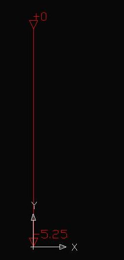

pontifex Posted March 1, 2010 Posted March 1, 2010 Hi guys. I`ve been using this forum for a quite while now and it was very helpful so far. Especially when it comes to this lisp. And i was wondering, since i`m a newbie to lisp, dont know how to exactly change this - is there a way to add to every positive values "+" sign at the beginning of text. When it comes to negatives it works like a charm. And one other thing - how can i set default value of decimal places to 2? Quote
Lee Mac Posted March 1, 2010 Posted March 1, 2010 Welcome to CADTutor This should be faster and more robust [b][color=RED]([/color][/b][b][color=BLUE]defun[/color][/b] c:ellev [b][color=RED]([/color][/b][b][color=BLUE]/[/color][/b] *error* Line Text P1 P2 PT PTW TSZE XW Y YW[b][color=RED])[/color][/b] [i][color=#990099];; Lee Mac ~ 01.03.10[/color][/i] [b][color=RED]([/color][/b][b][color=BLUE]defun[/color][/b] *error* [b][color=RED]([/color][/b]msg[b][color=RED])[/color][/b] [b][color=RED]([/color][/b][b][color=BLUE]or[/color][/b] [b][color=RED]([/color][/b][b][color=BLUE]wcmatch[/color][/b] [b][color=RED]([/color][/b][b][color=BLUE]strcase[/color][/b] msg[b][color=RED])[/color][/b] [b][color=#a52a2a]"*BREAK,*CANCEL*,*EXIT*"[/color][/b][b][color=RED])[/color][/b] [b][color=RED]([/color][/b][b][color=BLUE]princ[/color][/b] [b][color=RED]([/color][/b][b][color=BLUE]strcat[/color][/b] [b][color=#a52a2a]"\n** Error: "[/color][/b] msg [b][color=#a52a2a]" **"[/color][/b][b][color=RED])[/color][/b][b][color=RED])[/color][/b][b][color=RED])[/color][/b] [b][color=RED]([/color][/b][b][color=BLUE]princ[/color][/b][b][color=RED])[/color][/b][b][color=RED])[/color][/b] [b][color=RED]([/color][/b][b][color=BLUE]defun[/color][/b] Line [b][color=RED]([/color][/b]p1 p2[b][color=RED])[/color][/b] [b][color=RED]([/color][/b][b][color=BLUE]entmakex[/color][/b] [b][color=RED]([/color][/b][b][color=BLUE]list[/color][/b] [b][color=RED]([/color][/b][b][color=BLUE]cons[/color][/b] [b][color=#009900]0[/color][/b] [b][color=#a52a2a]"LINE"[/color][/b][b][color=RED])[/color][/b] [b][color=RED]([/color][/b][b][color=BLUE]cons[/color][/b] [b][color=#009900]10[/color][/b] p1[b][color=RED])[/color][/b] [b][color=RED]([/color][/b][b][color=BLUE]cons[/color][/b] [b][color=#009900]11[/color][/b] p2[b][color=RED])[/color][/b][b][color=RED])[/color][/b][b][color=RED])[/color][/b][b][color=RED])[/color][/b] [b][color=RED]([/color][/b][b][color=BLUE]defun[/color][/b] Text [b][color=RED]([/color][/b]pt hgt str[b][color=RED])[/color][/b] [b][color=RED]([/color][/b][b][color=BLUE]entmakex[/color][/b] [b][color=RED]([/color][/b][b][color=BLUE]list[/color][/b] [b][color=RED]([/color][/b][b][color=BLUE]cons[/color][/b] [b][color=#009900]0[/color][/b] [b][color=#a52a2a]"TEXT"[/color][/b][b][color=RED])[/color][/b] [b][color=RED]([/color][/b][b][color=BLUE]cons[/color][/b] [b][color=#009900]10[/color][/b] pt[b][color=RED])[/color][/b] [b][color=RED]([/color][/b][b][color=BLUE]cons[/color][/b] [b][color=#009900]40[/color][/b] hgt[b][color=RED])[/color][/b] [b][color=RED]([/color][/b][b][color=BLUE]cons[/color][/b] [b][color=#009900]1[/color][/b] str[b][color=RED])[/color][/b][b][color=RED])[/color][/b][b][color=RED])[/color][/b][b][color=RED])[/color][/b] [b][color=RED]([/color][/b][b][color=BLUE]or[/color][/b] *scl [b][color=RED]([/color][/b][b][color=BLUE]setq[/color][/b] *scl [b][color=#009900]100[/color][/b][b][color=RED])[/color][/b][b][color=RED])[/color][/b] [b][color=RED]([/color][/b][b][color=BLUE]setq[/color][/b] *scl [b][color=RED]([/color][/b][b][color=BLUE]cond[/color][/b] [b][color=RED]([/color][/b][b][color=RED]([/color][/b][b][color=BLUE]getint[/color][/b] [b][color=RED]([/color][/b][b][color=BLUE]strcat[/color][/b] [b][color=#a52a2a]"\nEnter Drawing Scale <"[/color][/b] [b][color=RED]([/color][/b][b][color=BLUE]itoa[/color][/b] *scl[b][color=RED])[/color][/b] [b][color=#a52a2a]"> : "[/color][/b][b][color=RED])[/color][/b][b][color=RED])[/color][/b][b][color=RED])[/color][/b] [b][color=RED]([/color][/b]*scl[b][color=RED])[/color][/b][b][color=RED])[/color][/b][b][color=RED])[/color][/b] [b][color=RED]([/color][/b][b][color=BLUE]setq[/color][/b] tsze [b][color=RED]([/color][/b][b][color=BLUE]*[/color][/b] [b][color=#009999]0.002[/color][/b] *scl[b][color=RED])[/color][/b][b][color=RED])[/color][/b] [b][color=RED]([/color][/b][b][color=BLUE]while[/color][/b] [b][color=RED]([/color][/b][b][color=BLUE]setq[/color][/b] pt [b][color=RED]([/color][/b][b][color=BLUE]getpoint[/color][/b] [b][color=#a52a2a]"\nPick Elevation Line Point: "[/color][/b][b][color=RED])[/color][/b][b][color=RED])[/color][/b] [b][color=RED]([/color][/b][b][color=BLUE]setq[/color][/b] ptw [b][color=RED]([/color][/b][b][color=BLUE]trans[/color][/b] pt [b][color=#009900]1[/color][/b] [b][color=#009900]0[/color][/b][b][color=RED])[/color][/b] xw [b][color=RED]([/color][/b][b][color=BLUE]car[/color][/b] ptw[b][color=RED])[/color][/b] yw [b][color=RED]([/color][/b][b][color=BLUE]cadr[/color][/b] ptw[b][color=RED])[/color][/b] y [b][color=RED]([/color][/b][b][color=BLUE]cadr[/color][/b] pt[b][color=RED])[/color][/b][b][color=RED])[/color][/b] [b][color=RED]([/color][/b][b][color=BLUE]setq[/color][/b] p1 [b][color=RED]([/color][/b][b][color=BLUE]list[/color][/b] [b][color=RED]([/color][/b][b][color=BLUE]-[/color][/b] xw [b][color=RED]([/color][/b][b][color=BLUE]/[/color][/b] tsze [b][color=#009900]2[/color][/b][b][color=RED])[/color][/b][b][color=RED])[/color][/b] [b][color=RED]([/color][/b][b][color=BLUE]+[/color][/b] yw tsze[b][color=RED])[/color][/b] [b][color=#009999]0.[/color][/b][b][color=RED])[/color][/b] p2 [b][color=RED]([/color][/b][b][color=BLUE]list[/color][/b] [b][color=RED]([/color][/b][b][color=BLUE]+[/color][/b] xw [b][color=RED]([/color][/b][b][color=BLUE]/[/color][/b] tsze [b][color=#009900]2[/color][/b][b][color=RED])[/color][/b][b][color=RED])[/color][/b] [b][color=RED]([/color][/b][b][color=BLUE]+[/color][/b] yw tsze[b][color=RED])[/color][/b] [b][color=#009999]0.[/color][/b][b][color=RED])[/color][/b][b][color=RED])[/color][/b] [b][color=RED]([/color][/b][b][color=BLUE]mapcar[/color][/b] [b][color=RED]([/color][/b][b][color=BLUE]function[/color][/b] [b][color=RED]([/color][/b][b][color=BLUE]lambda[/color][/b] [b][color=RED]([/color][/b]x[b][color=RED])[/color][/b] [b][color=RED]([/color][/b]line ptw x[b][color=RED])[/color][/b][b][color=RED])[/color][/b][b][color=RED])[/color][/b] [b][color=RED]([/color][/b][b][color=BLUE]list[/color][/b] p1 p2[b][color=RED])[/color][/b][b][color=RED])[/color][/b] [b][color=RED]([/color][/b]line p1 p2[b][color=RED])[/color][/b] [b][color=RED]([/color][/b]Text [b][color=RED]([/color][/b][b][color=BLUE]list[/color][/b] xw [b][color=RED]([/color][/b][b][color=BLUE]+[/color][/b] yw tsze[b][color=RED])[/color][/b] [b][color=#009999]0.[/color][/b][b][color=RED])[/color][/b] tsze [b][color=RED]([/color][/b][b][color=BLUE]strcat[/color][/b] [b][color=RED]([/color][/b][b][color=BLUE]if[/color][/b] [b][color=RED]([/color][/b][b][color=BLUE]<=[/color][/b] [b][color=#009900]0[/color][/b] y[b][color=RED])[/color][/b] [b][color=#a52a2a]"+"[/color][/b] [b][color=#a52a2a]""[/color][/b][b][color=RED])[/color][/b] [b][color=RED]([/color][/b][b][color=BLUE]rtos[/color][/b] y [b][color=#009900]2[/color][/b] [b][color=#009900]2[/color][/b][b][color=RED])[/color][/b][b][color=RED])[/color][/b][b][color=RED])[/color][/b][b][color=RED])[/color][/b] [b][color=RED]([/color][/b][b][color=BLUE]princ[/color][/b][b][color=RED])[/color][/b][b][color=RED])[/color][/b] Quote
pontifex Posted March 1, 2010 Posted March 1, 2010 Thanks for quick reply Lee. The thing is - it doesn't work in local UCS. Is there a way to adjust it? Quote
Lee Mac Posted March 1, 2010 Posted March 1, 2010 Thanks for quick reply Lee. The thing is - it doesn't work in local UCS. Is there a way to adjust it? It should account for UCS other than World Quote
pontifex Posted March 1, 2010 Posted March 1, 2010 It seems that it doesn't. The other thing is that when i click at a point with integer value (0 for example in the attach.) , it doesnt put +0,00 as i was hoping it to do. Quote
Lee Mac Posted March 1, 2010 Posted March 1, 2010 The other thing is that when i click at a point with integer value (0 for example in the attach.) , it doesnt put +0,00 as i was hoping it to do. It is set to show three d.p. - the trailing zeros are affected by your Sys Var settings, not my code. Quote
Lee Mac Posted March 1, 2010 Posted March 1, 2010 As for the UCS thing - the point was correct, just the elevation text was relative to WCS, not UCS. I have updated the original code to account for this. Quote
alanjt Posted March 1, 2010 Posted March 1, 2010 It is set to show three d.p. - the trailing zeros are affected by your Sys Var settings, not my code. Check the dimzin variable. Quote
pontifex Posted March 1, 2010 Posted March 1, 2010 :ouch:Found it, my mistake. Sorry. Didn't realize it wasn't the code. I hope this isn't one of the stupid questions: can the code use curently used text style or it can only use the standard/default one? My text font in the drawings isn't the "Standard" one used as default by Autocad. Everything else works perfect! Thank You Lee Quote
Lee Mac Posted March 1, 2010 Posted March 1, 2010 can the code use curently used text style or it can only use the standard/default one? Certainly: [b][color=RED]([/color][/b][b][color=BLUE]defun[/color][/b] c:ellev [b][color=RED]([/color][/b][b][color=BLUE]/[/color][/b] *error* Line Text P1 P2 PT PTW TSZE XW Y YW[b][color=RED])[/color][/b] [i][color=#990099];; Lee Mac ~ 01.03.10[/color][/i] [b][color=RED]([/color][/b][b][color=BLUE]defun[/color][/b] *error* [b][color=RED]([/color][/b]msg[b][color=RED])[/color][/b] [b][color=RED]([/color][/b][b][color=BLUE]or[/color][/b] [b][color=RED]([/color][/b][b][color=BLUE]wcmatch[/color][/b] [b][color=RED]([/color][/b][b][color=BLUE]strcase[/color][/b] msg[b][color=RED])[/color][/b] [b][color=#a52a2a]"*BREAK,*CANCEL*,*EXIT*"[/color][/b][b][color=RED])[/color][/b] [b][color=RED]([/color][/b][b][color=BLUE]princ[/color][/b] [b][color=RED]([/color][/b][b][color=BLUE]strcat[/color][/b] [b][color=#a52a2a]"\n** Error: "[/color][/b] msg [b][color=#a52a2a]" **"[/color][/b][b][color=RED])[/color][/b][b][color=RED])[/color][/b][b][color=RED])[/color][/b] [b][color=RED]([/color][/b][b][color=BLUE]princ[/color][/b][b][color=RED])[/color][/b][b][color=RED])[/color][/b] [b][color=RED]([/color][/b][b][color=BLUE]defun[/color][/b] Line [b][color=RED]([/color][/b]p1 p2[b][color=RED])[/color][/b] [b][color=RED]([/color][/b][b][color=BLUE]entmakex[/color][/b] [b][color=RED]([/color][/b][b][color=BLUE]list[/color][/b] [b][color=RED]([/color][/b][b][color=BLUE]cons[/color][/b] [b][color=#009900]0[/color][/b] [b][color=#a52a2a]"LINE"[/color][/b][b][color=RED])[/color][/b] [b][color=RED]([/color][/b][b][color=BLUE]cons[/color][/b] [b][color=#009900]10[/color][/b] p1[b][color=RED])[/color][/b] [b][color=RED]([/color][/b][b][color=BLUE]cons[/color][/b] [b][color=#009900]11[/color][/b] p2[b][color=RED])[/color][/b][b][color=RED])[/color][/b][b][color=RED])[/color][/b][b][color=RED])[/color][/b] [b][color=RED]([/color][/b][b][color=BLUE]defun[/color][/b] Text [b][color=RED]([/color][/b]pt hgt str[b][color=RED])[/color][/b] [b][color=RED]([/color][/b][b][color=BLUE]entmakex[/color][/b] [b][color=RED]([/color][/b][b][color=BLUE]list[/color][/b] [b][color=RED]([/color][/b][b][color=BLUE]cons[/color][/b] [b][color=#009900]0[/color][/b] [b][color=#a52a2a]"TEXT"[/color][/b][b][color=RED])[/color][/b] [b][color=RED]([/color][/b][b][color=BLUE]cons[/color][/b] [b][color=#009900]10[/color][/b] pt[b][color=RED])[/color][/b] [b][color=RED]([/color][/b][b][color=BLUE]cons[/color][/b] [b][color=#009900]40[/color][/b] hgt[b][color=RED])[/color][/b] [b][color=RED]([/color][/b][b][color=BLUE]cons[/color][/b] [b][color=#009900]1[/color][/b] str[b][color=RED])[/color][/b] [b][color=RED]([/color][/b][b][color=BLUE]cons[/color][/b] [b][color=#009900]7[/color][/b] [b][color=RED]([/color][/b][b][color=BLUE]getvar[/color][/b] [b][color=DARKRED]'[/color][/b]TEXTSTYLE[b][color=RED])[/color][/b][b][color=RED])[/color][/b][b][color=RED])[/color][/b][b][color=RED])[/color][/b][b][color=RED])[/color][/b] [b][color=RED]([/color][/b][b][color=BLUE]or[/color][/b] *scl [b][color=RED]([/color][/b][b][color=BLUE]setq[/color][/b] *scl [b][color=#009900]100[/color][/b][b][color=RED])[/color][/b][b][color=RED])[/color][/b] [b][color=RED]([/color][/b][b][color=BLUE]setq[/color][/b] *scl [b][color=RED]([/color][/b][b][color=BLUE]cond[/color][/b] [b][color=RED]([/color][/b][b][color=RED]([/color][/b][b][color=BLUE]getint[/color][/b] [b][color=RED]([/color][/b][b][color=BLUE]strcat[/color][/b] [b][color=#a52a2a]"\nEnter Drawing Scale <"[/color][/b] [b][color=RED]([/color][/b][b][color=BLUE]itoa[/color][/b] *scl[b][color=RED])[/color][/b] [b][color=#a52a2a]"> : "[/color][/b][b][color=RED])[/color][/b][b][color=RED])[/color][/b][b][color=RED])[/color][/b] [b][color=RED]([/color][/b]*scl[b][color=RED])[/color][/b][b][color=RED])[/color][/b][b][color=RED])[/color][/b] [b][color=RED]([/color][/b][b][color=BLUE]setq[/color][/b] tsze [b][color=RED]([/color][/b][b][color=BLUE]*[/color][/b] [b][color=#009999]0.002[/color][/b] *scl[b][color=RED])[/color][/b][b][color=RED])[/color][/b] [b][color=RED]([/color][/b][b][color=BLUE]while[/color][/b] [b][color=RED]([/color][/b][b][color=BLUE]setq[/color][/b] pt [b][color=RED]([/color][/b][b][color=BLUE]getpoint[/color][/b] [b][color=#a52a2a]"\nPick Elevation Line Point: "[/color][/b][b][color=RED])[/color][/b][b][color=RED])[/color][/b] [b][color=RED]([/color][/b][b][color=BLUE]setq[/color][/b] ptw [b][color=RED]([/color][/b][b][color=BLUE]trans[/color][/b] pt [b][color=#009900]1[/color][/b] [b][color=#009900]0[/color][/b][b][color=RED])[/color][/b] xw [b][color=RED]([/color][/b][b][color=BLUE]car[/color][/b] ptw[b][color=RED])[/color][/b] yw [b][color=RED]([/color][/b][b][color=BLUE]cadr[/color][/b] ptw[b][color=RED])[/color][/b] y [b][color=RED]([/color][/b][b][color=BLUE]cadr[/color][/b] pt[b][color=RED])[/color][/b][b][color=RED])[/color][/b] [b][color=RED]([/color][/b][b][color=BLUE]setq[/color][/b] p1 [b][color=RED]([/color][/b][b][color=BLUE]list[/color][/b] [b][color=RED]([/color][/b][b][color=BLUE]-[/color][/b] xw [b][color=RED]([/color][/b][b][color=BLUE]/[/color][/b] tsze [b][color=#009900]2[/color][/b][b][color=RED])[/color][/b][b][color=RED])[/color][/b] [b][color=RED]([/color][/b][b][color=BLUE]+[/color][/b] yw tsze[b][color=RED])[/color][/b] [b][color=#009999]0.[/color][/b][b][color=RED])[/color][/b] p2 [b][color=RED]([/color][/b][b][color=BLUE]list[/color][/b] [b][color=RED]([/color][/b][b][color=BLUE]+[/color][/b] xw [b][color=RED]([/color][/b][b][color=BLUE]/[/color][/b] tsze [b][color=#009900]2[/color][/b][b][color=RED])[/color][/b][b][color=RED])[/color][/b] [b][color=RED]([/color][/b][b][color=BLUE]+[/color][/b] yw tsze[b][color=RED])[/color][/b] [b][color=#009999]0.[/color][/b][b][color=RED])[/color][/b][b][color=RED])[/color][/b] [b][color=RED]([/color][/b][b][color=BLUE]mapcar[/color][/b] [b][color=RED]([/color][/b][b][color=BLUE]function[/color][/b] [b][color=RED]([/color][/b][b][color=BLUE]lambda[/color][/b] [b][color=RED]([/color][/b]x[b][color=RED])[/color][/b] [b][color=RED]([/color][/b]line ptw x[b][color=RED])[/color][/b][b][color=RED])[/color][/b][b][color=RED])[/color][/b] [b][color=RED]([/color][/b][b][color=BLUE]list[/color][/b] p1 p2[b][color=RED])[/color][/b][b][color=RED])[/color][/b] [b][color=RED]([/color][/b]line p1 p2[b][color=RED])[/color][/b] [b][color=RED]([/color][/b]Text [b][color=RED]([/color][/b][b][color=BLUE]list[/color][/b] xw [b][color=RED]([/color][/b][b][color=BLUE]+[/color][/b] yw tsze[b][color=RED])[/color][/b] [b][color=#009999]0.[/color][/b][b][color=RED])[/color][/b] tsze [b][color=RED]([/color][/b][b][color=BLUE]strcat[/color][/b] [b][color=RED]([/color][/b][b][color=BLUE]if[/color][/b] [b][color=RED]([/color][/b][b][color=BLUE]<=[/color][/b] [b][color=#009900]0[/color][/b] y[b][color=RED])[/color][/b] [b][color=#a52a2a]"+"[/color][/b] [b][color=#a52a2a]""[/color][/b][b][color=RED])[/color][/b] [b][color=RED]([/color][/b][b][color=BLUE]rtos[/color][/b] y [b][color=#009900]2[/color][/b] [b][color=#009900]2[/color][/b][b][color=RED])[/color][/b][b][color=RED])[/color][/b][b][color=RED])[/color][/b][b][color=RED])[/color][/b] [b][color=RED]([/color][/b][b][color=BLUE]princ[/color][/b][b][color=RED])[/color][/b][b][color=RED])[/color][/b] Glad the code works for you Quote
pontifex Posted March 1, 2010 Posted March 1, 2010 Lee, One other thing I realised, I promise While in the local UCS, can the text as well as the triangle automatically rotate to be parallel to the X axis just like it is when I'm in WCS? Quote
