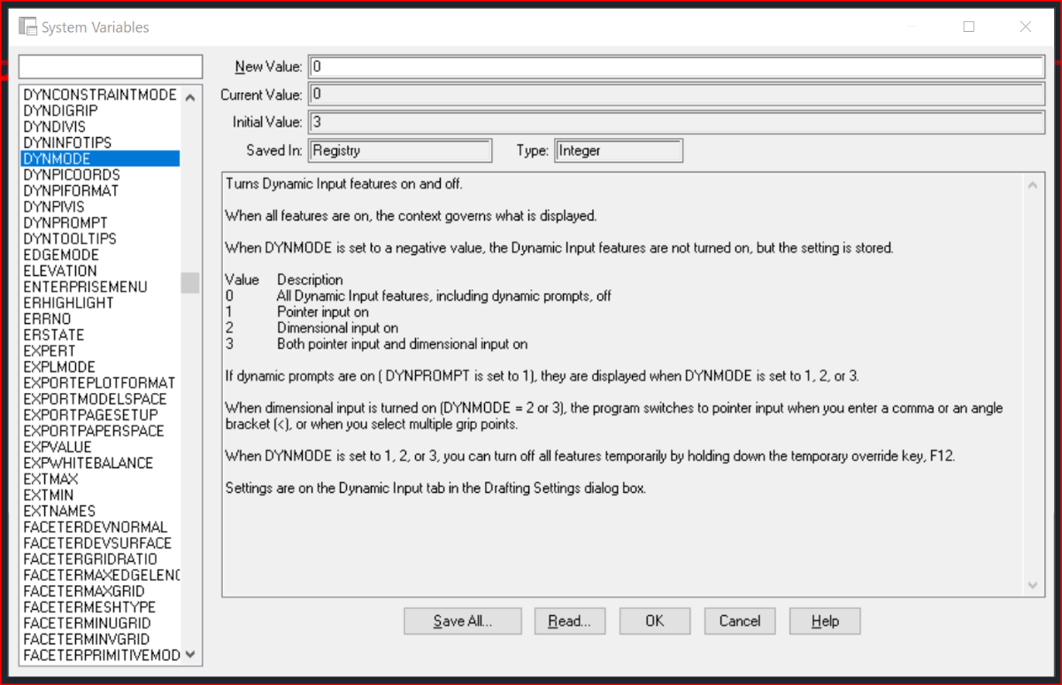

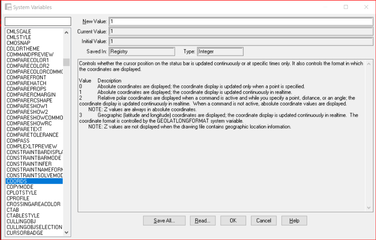

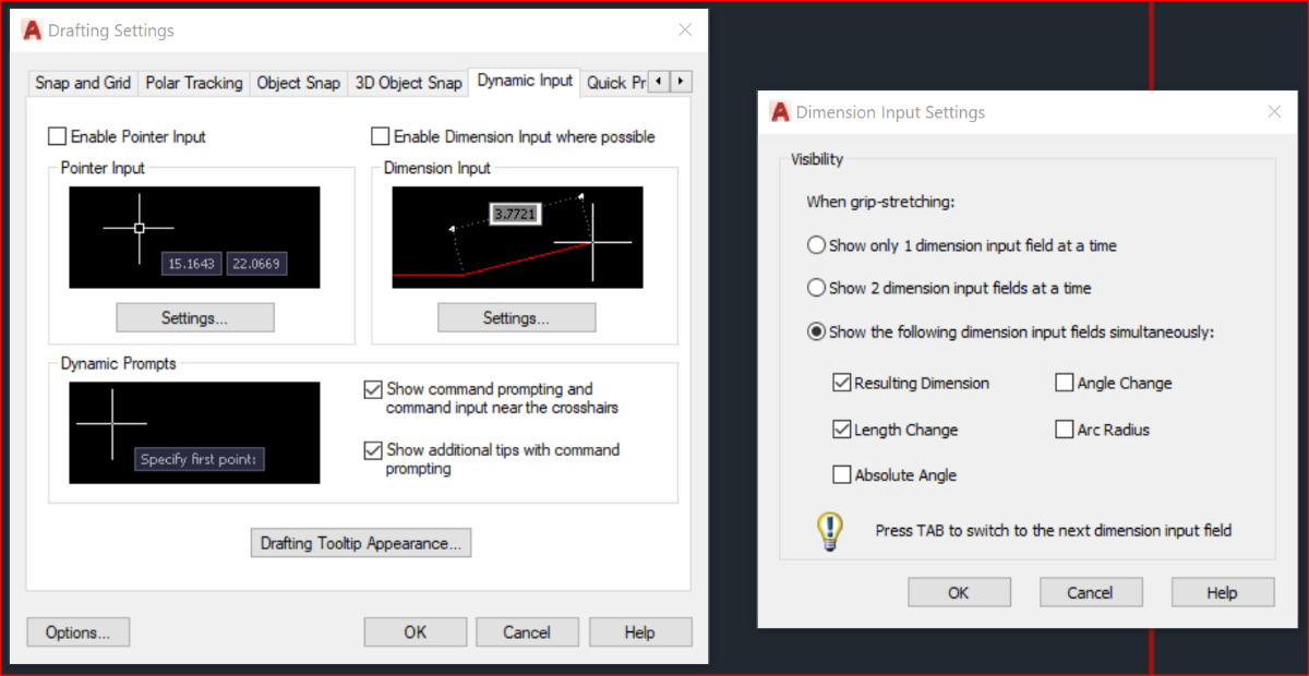

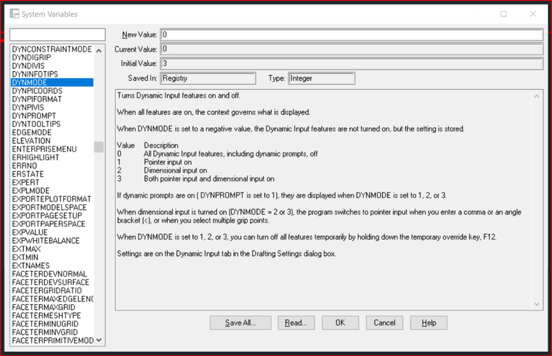

Dadgad Posted February 19 Share Posted February 19 Hi Pete, I am using Autocad 2020, so this may not help you, but it is worth a try. Use SYSVDLG to open your System Variables Dialog. If you are unfamiliar with it, it is always a good place to learn some new variable options, and to help troubleshoot issues you may encounter. I suggest that you look at DYNMODE variable setting options. If that doesn't do it for you, check out the next few beginning with DYN. Just use your ARROW to scroll down through the list, and they will open and let you take a quick look for likely suspects to help get you back on the tracks. Might you have an old .SVF file available? Which would include all of the settings which you favored in 2013. In the bottom of the SYSTEM VARIABLE DIALOG BOX, you will see the option to save such a file for your future reference. Always a good idea, even more so as you start to get it behaving how you like it. Good luck getting it back on the tracks. Another you may want to investigate is the COORDS System Variable in the same dialog box. As the COORDS default setting is probably still "1", you may want to try changing it to "2". These options are also displayed graphically in DRAFTING SETTINGS, on the DYNAMIC INPUT Tab. Quote Link to comment Share on other sites More sharing options...

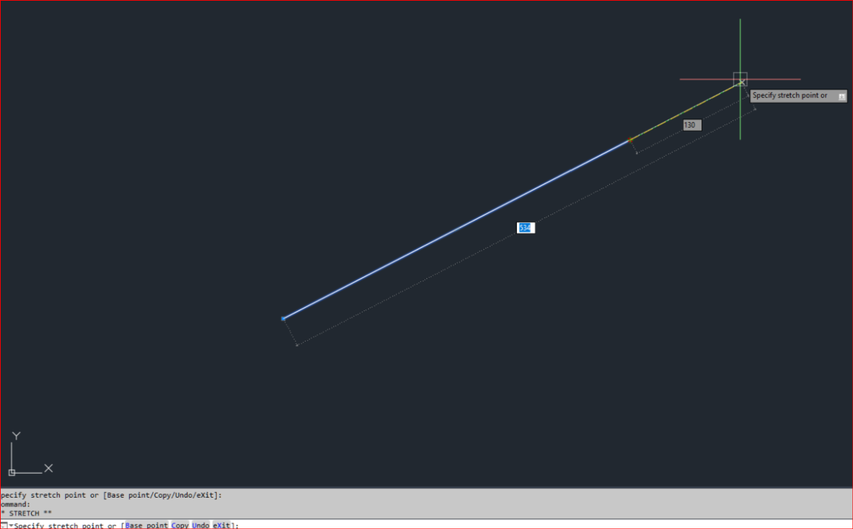

Dadgad Posted February 19 Share Posted February 19 There is also the STRETCH command, which can be used in either direction. Quote Link to comment Share on other sites More sharing options...
