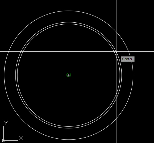

Why can not I pick the cirrcle
Try to draw a line from quadrant the snap goes to center only, even Nearest snap not selected.
Your circle is not in the world UCS.
If you set a UCS using the circle as the base, then all the snaps work perfectly.
Thanks
But not working.
That is curious, because it works for me, even with my old version of AutoCAD.
How are you setting up the UCS? Are you taking the Object option and then clicking on the circle?
However, if you do not want your circles giving you problems, you will have to redraw them flat.

Try to run this code on the circles
