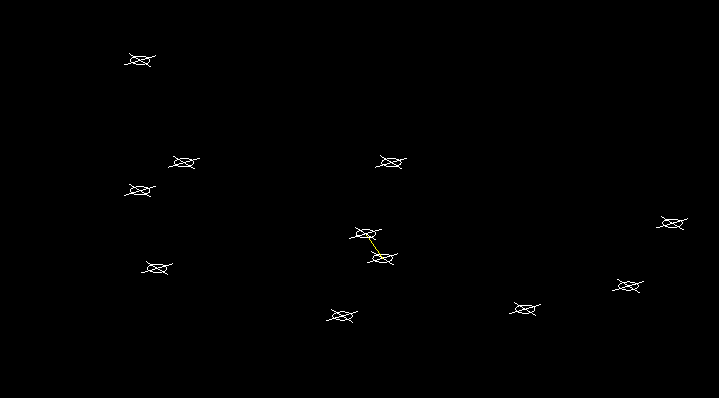

Hello,
I want to find and select the two closest points among the multiple points I will select.
It will be much appreciated if you give me some hints, thank you in advance.
Draw a line between the two closest points.

Hello robierzo
Many thanks for that, works..
But what I need is to select the points collectively from the screen rather than one by one. Then finding the two points closest to each other among these points..
Baris
work_01.dwg
You can also try this:

My solution:
(defun c:pp()
  (setq ss (ssget '((0 . "POINT"))) points (sslength ss) ps nil)
    (setq ps (cons (cdr (assoc 10 (entget (ssname ss (setq i (1- i)))))) ps)))
  (setq dl nil)
  (setq i -1)
  (repeat (1- points)
    (setq i (1+ i) j i p1 (nth i ps))
    (repeat (- points i 1)
      (setq j (1+ j) p2 (nth j ps) dist (distance p1 p2))
      (setq dl (cons (list dist p1 p2) dl))
  (setq mindist (apply 'min (mapcar 'car dl)))
  (foreach x dl
    (if (= mindist (car x)) (entmake (list '(0 . "LINE") '(62 . 3) (cons 10 (cadr x)) (cons 11 (caddr x)))))
  (strcat "Shortest distance= " (rtos mindist))
This will output in the command line the shortest distance. Also it will connect with a green line the point pairs placed at exactly that distance from each other.

Hello, Fuccaro
Thank you for the work, the lisp is successful and works as I want.
Many thanks
