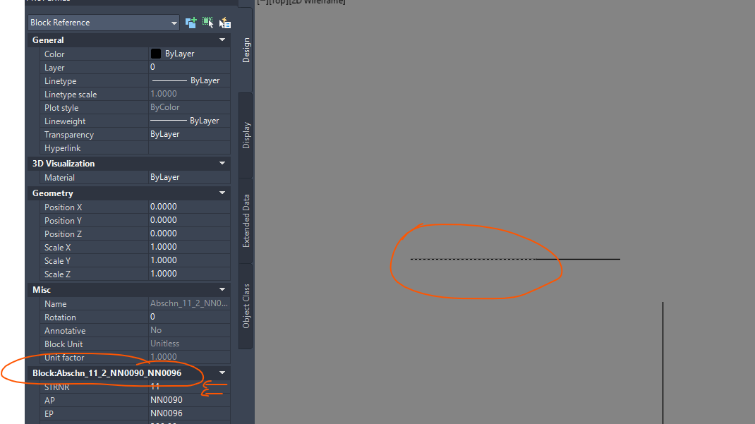

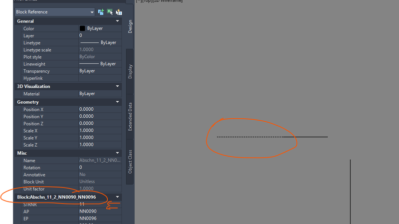

So, I do have a dxf file with objects exported from a different software, these objects seem to be recognized by Civil as blocks with attributes, and each object is assigned to a different block name. When trying to edit them couldn't find any attributes.
The problem here is there might be thousands like this in the file, and I do need to label them using 2 of their attributed fields to avoid doing this manually. I have tried different options of labelling available in civil 3d but got no results as don't know exactly what type of object they are. There might be an option to be able to extract the information from those objects. If somebody has an idea it will be much appreciated.
I have attached an example of how the properties field looks like when objects are selected.image.thumb.png.d7aa6d114e6635451cf796080f215ee8.png
1.dwg
Ok you can get the blocks into a selection set using a wild card search as 1st step, can then get attributes. Then you can check for an attribute tagname.

It looks like the block name was built using the STRNR, AP, and EP values (not sure where the 2 came from). There's a clue to the type of object in the name: Ab is a prefix for almost all proxy objects, so schn may tell you what kind of object it should be. As BigAl suggests, you may be able to read the attribute data and create... uh, whatever you need to create using that data.

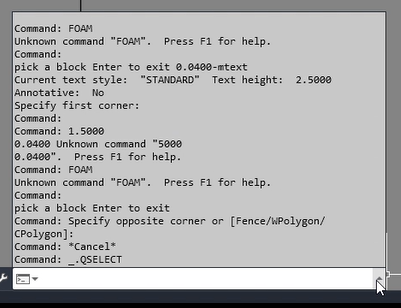

Now I am confused myself as well. Is either I am doing something wrong or my Cad is missing something.
It looks is listing something but for sure there is no text in the model space. Looks like the results of the listing are considered commands. Still got the error of function not recognized. After calling the function from the command bar it asks me to select the blocks but got the unknown command as a result. If I expand the command prompt I got this. It might be something I am doing wrong.
