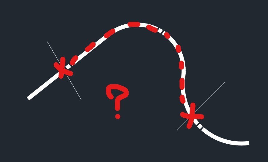

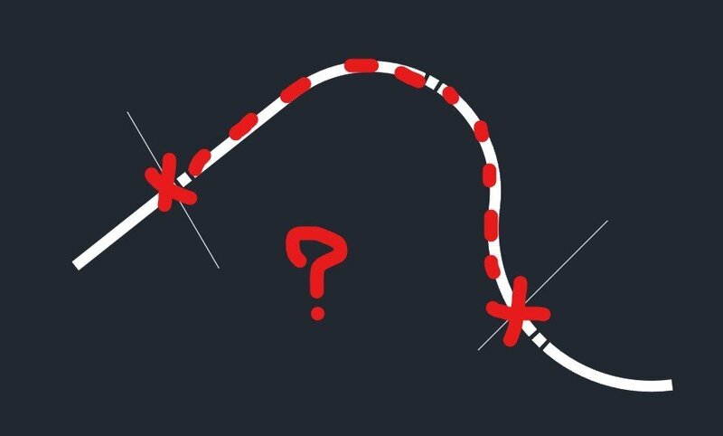

Addison Posted February 21 Share Posted February 21 I have a complex line made up of lines and arcs (a roadway baseline). The complex line is intersected by two other lines. How do I measure the distance along the complex line between the two intersections? MicroStation has a very useful "measure along" tool for this. I have not been able to find a tool in AutoCAD to do this. Quote Link to comment Share on other sites More sharing options...
BIGAL Posted February 22 Share Posted February 22 You need to run a function twice so get the distance from the start of a pline to where 1st line crosses, then do again for 2nd line crossing distance = dist1-dist2 (setq pt1 (vlax-invoke obj2 'intersectWith obj1 acExtendThisEntity)) (setq dist1 (vlax-curve-getdistatpoint obj pt1)) (setq pt2 (vlax-invoke obj3 'intersectWith obj1 acExtendThisEntity)) (setq dist2 (vlax-curve-getdistatpoint obj pt2)) Another way is trim the pline using the 2 crossing lines, get the remaining pline length, then do Undo to restore pline. You are correct as far as I know no built in function but an easy task manually or lisp. Quote Link to comment Share on other sites More sharing options...

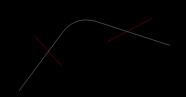

BIGAL Posted February 24 Share Posted February 24 (edited) Try this expects a crossing object so dont pick say intersection. (defun c:d2 ( / obj1 obj2 obj3 intpt1 intp2 d1 d2) (setq obj1 (vlax-ename->vla-object (car (entsel "Pick line/pline/arc ")))) (setq obj2 (vlax-ename->vla-object (car (entsel "Pick 1st crossing line/pline/arc ")))) (setq obj3 (vlax-ename->vla-object (car (entsel "Pick 2nd crossing line/pline/arc ")))) (setq intpt1 (vlax-invoke obj2 'intersectWith obj1 acExtendnone)) (setq intpt2 (vlax-invoke obj3 'intersectWith obj1 acExtendnone)) (setq d1 (vlax-curve-getdistatpoint obj1 intpt1)) (setq d2 (vlax-curve-getdistatpoint obj1 intpt2)) (alert (strcat "Distance is " (rtos (abs (- d2 d1)) 2 3))) (princ) ) Almost forgot you can take this lisp and use Appload save to Startup suite then is ready all the time. I load a lisp on startup with about 30 defuns common stuff used all the time. Or add to the Pop menu, Toolbar menu or Ribbon. I would strongly suggest if your going to add lots more functions that you make Custom menu's dont add to the default Acad etc. Edited February 24 by BIGAL Quote Link to comment Share on other sites More sharing options...
