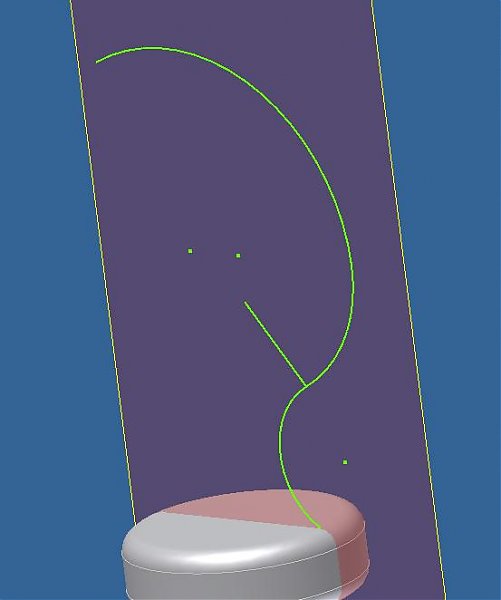

alright red here are some screen shots. I tried to make something that looked like your model.
Picture 1 is the model space with my XY plane visible(red outlined with yellow).

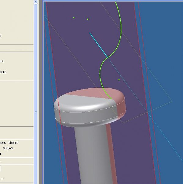

Second picture you can see the work plane button depressed, and my sketch line(where you were asking about a plane) is now red and has a large extension. This is because after i selected Work Plane(or hit the ] button) i selected my line(telling Inventor i wasnt to rotate about this axis).

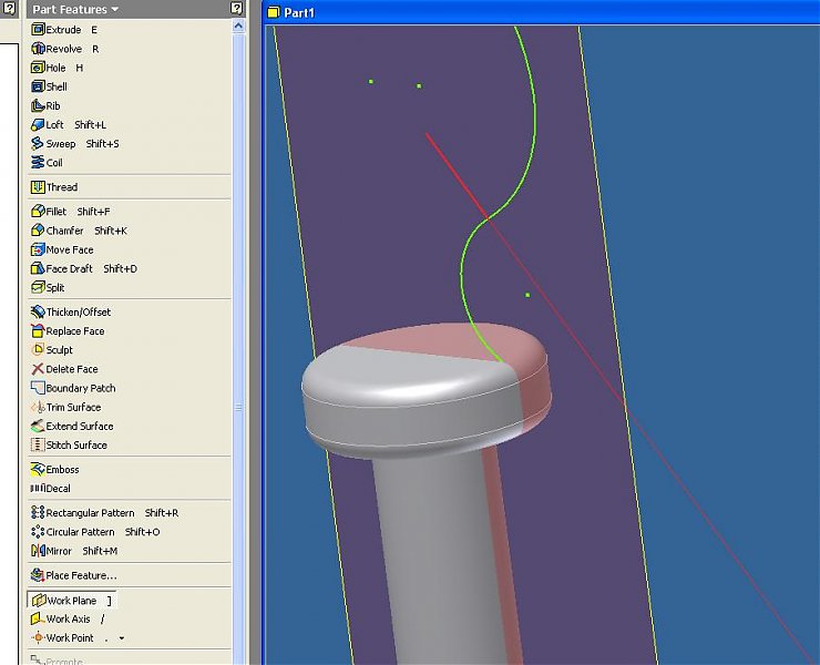

Third picture, That line has now turned blue and you can see my plane now has some red lines around it and there is a ghost image of a plane. Select this xy plane(not sure if its xy in your model but whichever plane goes vertically through your part that you drew your "hook" on)

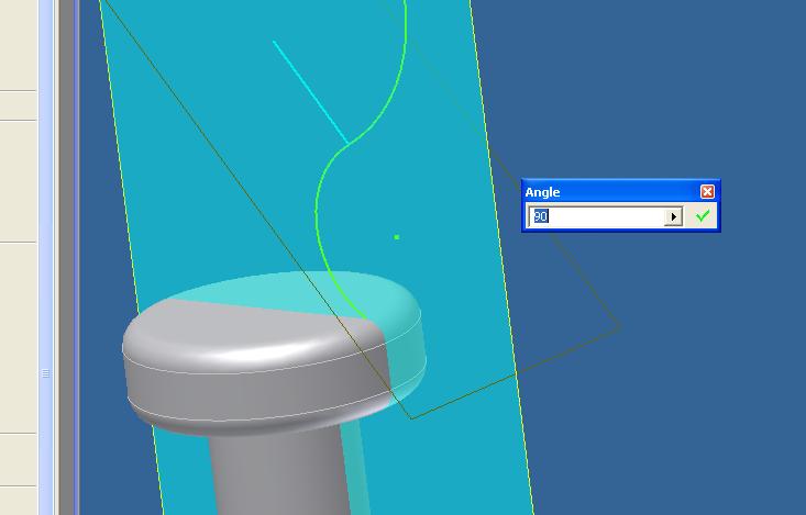

Fourth pic, After the plane was selected(now highlighted as well as my reference line) it prompts you for an angle. This is the angle you want to take that original plane(xy in my case) and rotate it about the reference line you selected. 90 degrees as JD pointed out, will give you the plane you are looking for. 90 is the default entry.

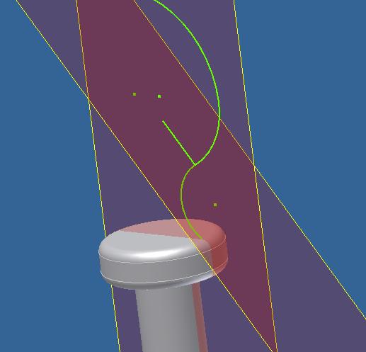

fifth pic is my new plane now created.
