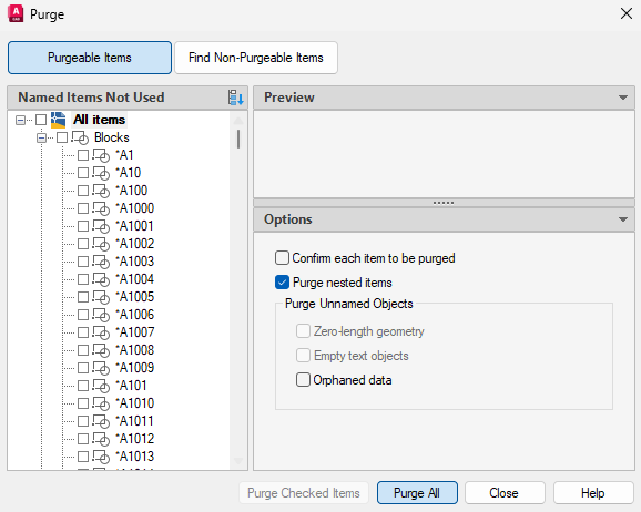

The size of this file is more than 4 megabytes. But it is logical that the size of the file should be less than 100 kilobytes
I also used the purge and audit commands, but the problem was not solved 🤔

An interesting command is STATUS which shows that the original drawing has 142933 objects. It also has 8974 unnamed blocks besides many linetypes, etc..
When I WBLOCK this drawing with a window to choose the line and text only, the file size decreases to 73 KB.

This is probably the bulk of the bloat: ACAD_DGNLINESTYLECOMP.Count = 78790
This will allow all the anonymous blocks to be purged .. and the file size for me after removing those is 21 KB.
 (dictremove (namedobjdict) "ACAD_DGNLINESTYLECOMP")
