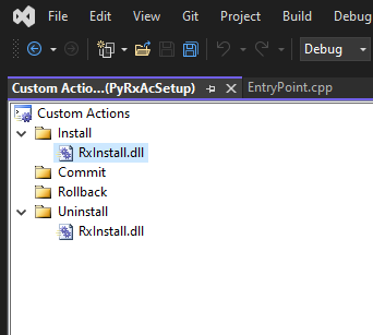

Danielm103 Posted February 27 Share Posted February 27 It’s a good question You can set the MSI to use custom actions. The installer can invoke methods in a separate DLL. This DLL can be C/C++ or .NET… or whatever I usually use two custom action functions RxInstall, RxUninstall, example. static HMODULE ghThisModule = NULL; #define DllExport __declspec( dllexport ) std::filesystem::path getModulePath() { TCHAR modPath[MAX_PATH] = { 0 }; GetModuleFileName(ghThisModule, modPath, MAX_PATH); return std::filesystem::path{ modPath }; } EXTERN_C DllExport UINT WINAPI RxInstall(MSIHANDLE hInstall) { std::filesystem::path path = getModulePath(); RxEnvironment& env = RxEnvironment::instance(path, hInstall); env.install(); // DO the install return ERROR_SUCCESS; } EXTERN_C DllExport UINT WINAPI RxUninstall(MSIHANDLE hInstall) { std::filesystem::path path = getModulePath(); RxEnvironment& env = RxEnvironment::instance(path, hInstall); env.uninstall();// DO the uninstall return ERROR_SUCCESS; } BOOL APIENTRY DllMain(HMODULE hModule, DWORD dwReason, LPVOID lpReserved) { if (dwReason == DLL_PROCESS_ATTACH) { DisableThreadLibraryCalls(hModule); ghThisModule = hModule; } return TRUE; } These functions are sent a MSIHANDLE to provide context. They are invoked by thin installer under the rights/credentials, which may or may not be limited. Anyway, from here you can play with the registry, environment, files etc. BricsCAD you must add an autoload entry to the registry, which is a bummer. AutoCAD I use the bundle. Note: I really try avoid writing to the registry, so for persistent settings, I usually use SQLite or a file. Menus, I usually create a partial CUIX, or I load them dynamically Quote Link to comment Share on other sites More sharing options...

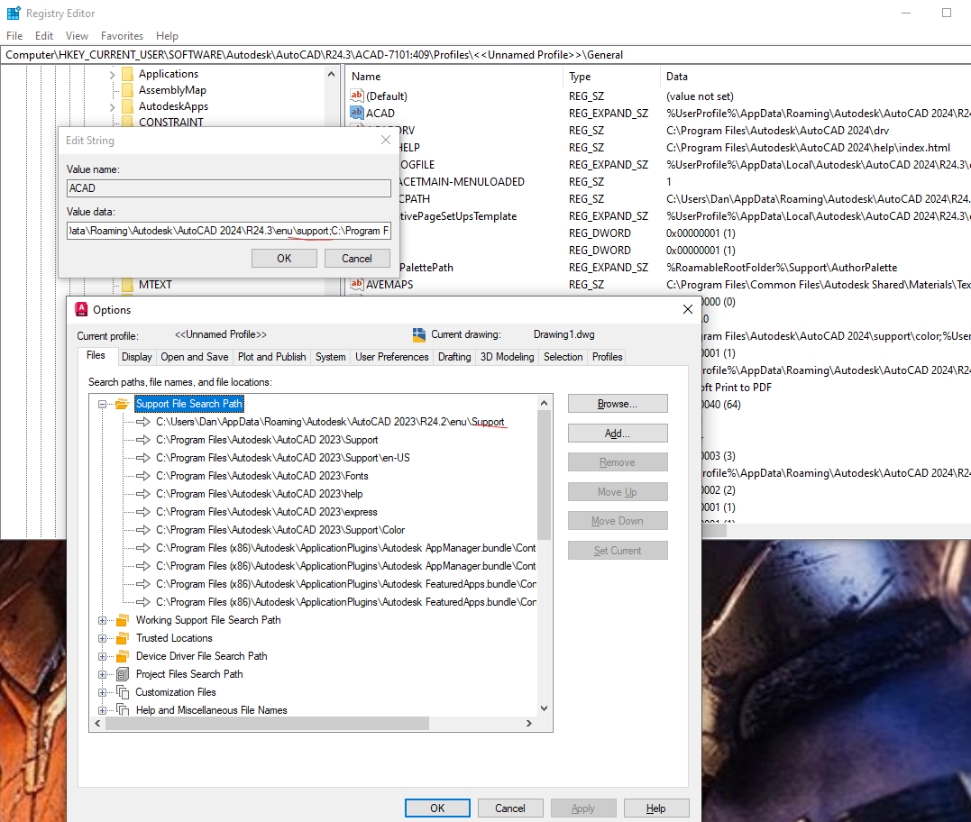

Danielm103 Posted February 27 Share Posted February 27 sorry I can’t be of more help, I’m not familiar with the tool palettes. how my installer can add paths to the AutoCAD "supporting file" in the target pc? A, this value is stored in the registry, in the profile section, you must add it yourself from an installer perspective Quote Link to comment Share on other sites More sharing options...
