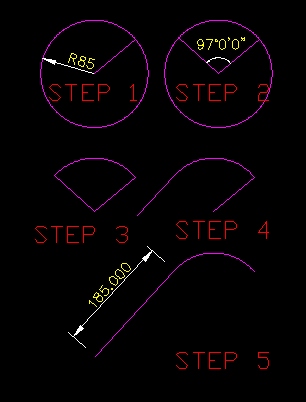

I need to draw an arc, this arc curves to the left, it has a radius of 85' and it's delta angle is 97 degrees... it then travels 185.
I'm having a few issues, first off, the way i'm approaching this isn't right, somewhere i'm not doing this right...

Another way is to draw a circle with R85'. Draw the first radius line to the point you want on the circle for the start pount of the arc. Then copy/rotate that line 97 degrees using the circle centre as the base point. Then use both lines to trim the circle of the unwanted bit. Delete the first line, and rotate the 2nd line 90 degrees using the new arc end point as the rotation point. Then LENGTHEN that line to 185 feet.

thanks mate!
