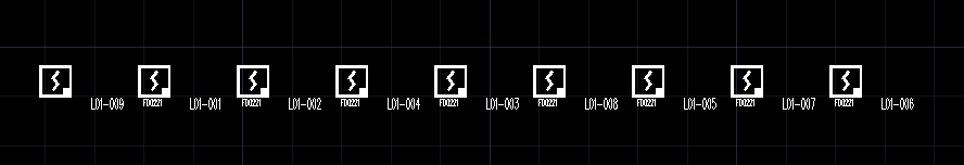

hello I have a synoptic lisp which classifies the blocks by "attributes" ADDRESS. it works if the address is entered like this.
001 002 003 004...etc
Or
1 2 3 4 etc....
I would like it if it could put the blocks in order with the address entered like this.
L1-001 L1-002 L1-003 etc....
Or
1/1/1-001 1/1/1-002
1/1/1-003
1/1/1-004 etc.
Thank you for your help
kind regards
Philip

Hello I know this lisp but it does not split the blocks by attribute address

The attributes is not ADRESS but Ordre. 😉

Here is my try:

Hello, fuccaro
thank you very much it works really well. a big thank-you you are fantastic.
