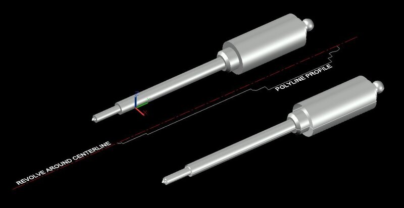

Cad64 Posted March 3 Share Posted March 3 In order to Revolve, all you need is half the polyline profile and then Revolve it around the centerline. See the image below and the attached CAD file. bandymas 3d-2.dwg Quote Link to comment Share on other sites More sharing options...

Cad64 Posted March 4 Share Posted March 4 3 hours ago, snoww said: Hello, thank you for your help. I wanted to ask how did you convert the wireframe to solid object, because when i try to convert to solid, i get an error I didn't convert anything. I just Revolved the polyline profile. Quote Link to comment Share on other sites More sharing options...
