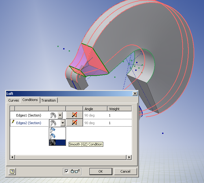

JD Mather Posted March 8, 2009 Share Posted March 8, 2009 Then I lofted the main center section using all of the rails. Quote Link to comment Share on other sites More sharing options...
JD Mather Posted March 8, 2009 Share Posted March 8, 2009 Then I blended the end to the middle section using Loft with G2 smooth tangency. Keep in mind to select the center rails you have to pick twice - once to select the sketch and a second time to select the rail. Finally, I added Variable Radius Fillets to the hook edges. This takes a lot of experimentation and prior knowledge to get them to work out. Now that you understand the geometry doing different itterations takes much less time. Quote Link to comment Share on other sites More sharing options...
JD Mather Posted March 8, 2009 Share Posted March 8, 2009 I should have pointed out - when doing blending fillets like shown in the previous post - select the faces of the part rather than sketches for the section profiles or you won't get the option for G2 tangency. Quote Link to comment Share on other sites More sharing options...

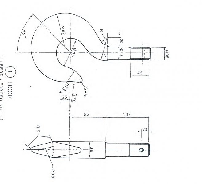

lis_wang Posted February 18, 2010 Share Posted February 18, 2010 How to create this hook in the attached file? Would you like to email the hook you created to me? Quote Link to comment Share on other sites More sharing options...
JD Mather Posted February 18, 2010 Share Posted February 18, 2010 Attach what you have completed so far. Quote Link to comment Share on other sites More sharing options...
lis_wang Posted February 18, 2010 Share Posted February 18, 2010 The attachment is the hook I created. I do not know how to make the sharp corner to sphere R6. hook.zip Quote Link to comment Share on other sites More sharing options...

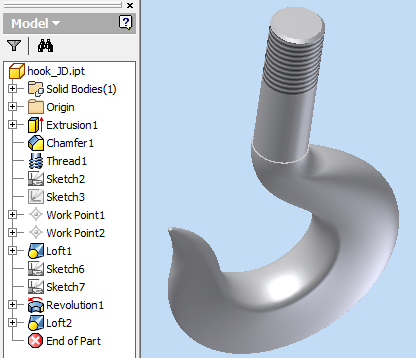

JD Mather Posted February 22, 2010 Share Posted February 22, 2010 This could be simplified a bit more as a couple of the sketches aren't really needed. The Workpoints aren't really needed. Well looks like I will have to simplify as it won't quite fit here because of filesize. Just realized I had the Spherical Radius as 2 rather than as 6 like print dimension. I will post corrected attachment when I get it under 250K. Quote Link to comment Share on other sites More sharing options...
JD Mather Posted February 22, 2010 Share Posted February 22, 2010 I made a mistake causing to have to do the Loft as a surface and then Sculpt to get solid (bit tricky to explain the mistake). So the Sculpt is an extra step, but you should get the idea. To reduce file size I omitted the cylinder, chamfer and thread. Hook_JD_Rev1.zip Quote Link to comment Share on other sites More sharing options...

linnmaster Posted February 23, 2010 Share Posted February 23, 2010 My question is why can't the first loft be created as solid? It seems to fail and only works with surface ... And the other question is that for Loft1, you've got both tangent conditions on both edges that are selected ... When I tried tangent on both, it turns really ugly ... only on the edge at the tip radius 6 end it becomes more like "normal" when the "tangent" condition is selected ... the other end is fine and works with tangent, like it should. Any idea why the different results between the two? Quote Link to comment Share on other sites More sharing options...
shift1313 Posted February 23, 2010 Share Posted February 23, 2010 My question is why can't the first loft be created as solid? It seems to fail and only works with surface ... And the other question is that for Loft1, you've got both tangent conditions on both edges that are selected ... When I tried tangent on both, it turns really ugly ... only on the edge at the tip radius 6 end it becomes more like "normal" when the "tangent" condition is selected ... the other end is fine and works with tangent, like it should. Any idea why the different results between the two? which hook are you speaking of? JD used Smooth(G2) tangency. It will produce a different result than tangent. Quote Link to comment Share on other sites More sharing options...

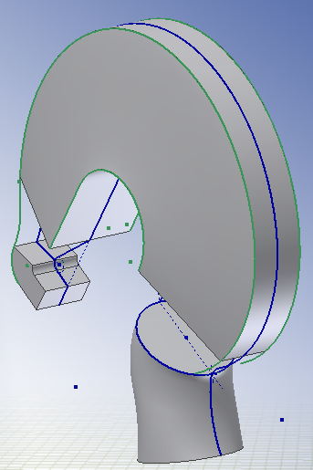

linnmaster Posted February 23, 2010 Share Posted February 23, 2010 I can't seem to get my file small enough - I'm out by 8kb ... here is a screen shot of what happens on the final loft3 when both edge conditions are set with tangency condition ... Anyways, I just recreated the features that JD did on his (or tried to), using his sketches ... and it seems like my end result is different ... Quote Link to comment Share on other sites More sharing options...
linnmaster Posted February 23, 2010 Share Posted February 23, 2010 I just realised something ... I seem to have two solid bodies ... and I think this is creating my problems seen above ... Nope ... got it as one solid, but symptoms are still the same as above with tangency condition set on both edges on final loft ... Quote Link to comment Share on other sites More sharing options...

linnmaster Posted February 23, 2010 Share Posted February 23, 2010 which hook are you speaking of? JD used Smooth(G2) tangency. It will produce a different result than tangent. In JD's model, he didn't use Smooth(G2). He used Tangent. When I use Tangent, I get what you see in my screen shot above. To get something similar to JD's rev1 model, I had to use Free. Using Smooth(G2) becomes too fat. Regards, David Quote Link to comment Share on other sites More sharing options...

JD Mather Posted February 24, 2010 Share Posted February 24, 2010 ...here is a screen shot of what happens on the final loft3 Did you take a look at the Rev2 file I posted? You need to be careful where you select the edges for the loft. Click on the planar faces near the edge or the tangency will be to incorrect face. Note also that must have existing solid faces or surfaces to get the tangent options. Lofts with sketches do not give this option. Quote Link to comment Share on other sites More sharing options...
