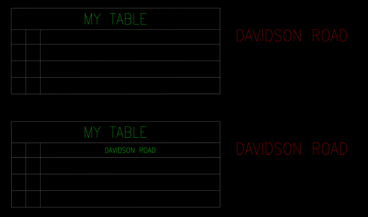

Sinabro Posted March 11 Share Posted March 11 I am looking for an LSP file for multiple selections to copy into table cells. For example: If I have two separate texts, '851' and 'Davidson RD", can I use a command to pick '851' and 'Davidson Rd' and automatically fill up a table cell? after click cell? Does anyone have any ideas? Please help and provide the lsp file... Quote Link to comment Share on other sites More sharing options...

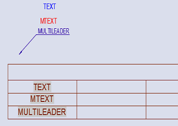

Nikon Posted March 12 Share Posted March 12 (edited) The author of Lisp is koMon Select the TEXT (MTEXT, MULTILEADER) and paste the field into a table cell. mltxt_cell.lsp Edited March 14 by Nikon Quote Link to comment Share on other sites More sharing options...

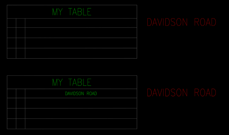

Jonathan Handojo Posted March 14 Share Posted March 14 A bit on the longer side, but maybe this: (defun c:fo ( / a c dir ent i pt r ss sstb txt) (cond ( (not (setq sstb (ssget "_X" (append (list '(0 . "ACAD_TABLE") '(-4 . "<OR") ) (mapcar '(lambda (a) (cons 8 (LM:escapewildcards a)) ) (JH:GetLockedFrozenOffLayers nil nil nil nil) ) (list '(-4 . "OR>") (cons 410 (if (= (getvar "cvport") 1) (getvar "ctab") "Model")) ) ) ) ) ) (princ (if (= (getvar "cvport") 1) "\nNo tables in current paper space." "\nNo tables in model space.")) ) ( (not (setq ss (ssget '((0 . "TEXT,MTEXT")))))) ( (setq sstb (JH:selset-to-list-vla sstb)) (repeat (setq i (sslength ss)) (setq i (1- i) ent (ssname ss i) txt (cons (vla-get-TextString (vlax-ename->vla-object ent)) txt) ) ) (setq txt (LM:lst->str txt " ")) (while (progn (setvar "errno" 0) (initget "Exit") (setq pt (getpoint "\nSpecify table cell [Exit] <exit>: ")) (cond ( (= (getvar "errno") 7) (princ "\nNothing selected.")) ( (member pt '("Exit" nil)) nil) ( (progn (setq pt (vlax-3d-point (trans pt 1 0)) dir (vlax-3d-point (getvar "viewdir"))) (vl-some (function (lambda (a) (if (eq (vla-hittest a pt dir 'r 'c) :vlax-true) (progn (if (not (zerop (logand accellstatecontentlocked (vla-getcellstate a r c)))) (princ "\nTable cell is locked.") (vla-settext a r c txt) ) t ) ) ) ) sstb ) ) ) ( (princ "\nNo table cell detected.")) ) ) ) ) ) ) ;; JH:GetLockedFrozenLayers --> Jonathan Handojo ;; Gets a list of layers that are locked and/or frozen. ;; lck - T to get locked layers, nil to get unlocked layers ;; frz - T to get frozen layers, nil to get thawed layers ;; off - T to get 'off' layers, nil to get 'on' layers ;; xref - T to include xref, nil to exclude xref (defun JH:GetLockedFrozenOffLayers (lck frz off xref / nm nx rtn) (while (setq nx (tblnext "layer" (null nx))) (setq nm (cdr (assoc 2 nx))) (if (not (and (not xref) (wcmatch nm "*|*"))) (if (and (or (and lck (= 4 (logand 4 (cdr (assoc 70 nx))))) (and (not lck) (zerop (logand 4 (cdr (assoc 70 nx))))) ) (or (and frz (= 1 (logand 1 (cdr (assoc 70 nx))))) (and (not frz) (zerop (logand 1 (cdr (assoc 70 nx))))) ) (or (and off (minusp (cdr (assoc 62 nx)))) (and (not off) (> (cdr (assoc 62 nx)) 0)) ) ) (setq rtn (cons nm rtn)) ) ) ) (reverse rtn) ) ;; JH:selset-to-list-vla --> Jonathan Handojo ;; Returns a list of vla objects from a selection set ;; ss - selection set (defun JH:selset-to-list-vla (ss / rtn i) (if ss (repeat (setq i (sslength ss)) (setq rtn (cons (vlax-ename->vla-object (ssname ss (setq i (1- i)))) rtn)) ) ) ) ;; Escape Wildcards - Lee Mac ;; Escapes wildcard special characters in a supplied string (defun LM:escapewildcards ( str ) (vl-list->string (apply 'append (mapcar '(lambda ( c ) (if (member c '(35 64 46 42 63 126 91 93 45 44)) (list 96 c) (list c) ) ) (vl-string->list str) ) ) ) ) ;; List to String - Lee Mac ;; Concatenates each string in a supplied list, separated by a given delimiter ;; lst - [lst] List of strings to concatenate ;; del - [str] Delimiter string to separate each item (defun LM:lst->str ( lst del / str ) (setq str (car lst)) (foreach itm (cdr lst) (setq str (strcat str del itm))) str ) The selected text will be concatenated together, using spaces. You may need to select the text by picking instead of window or crossing to get the text in order. 2 Quote Link to comment Share on other sites More sharing options...
