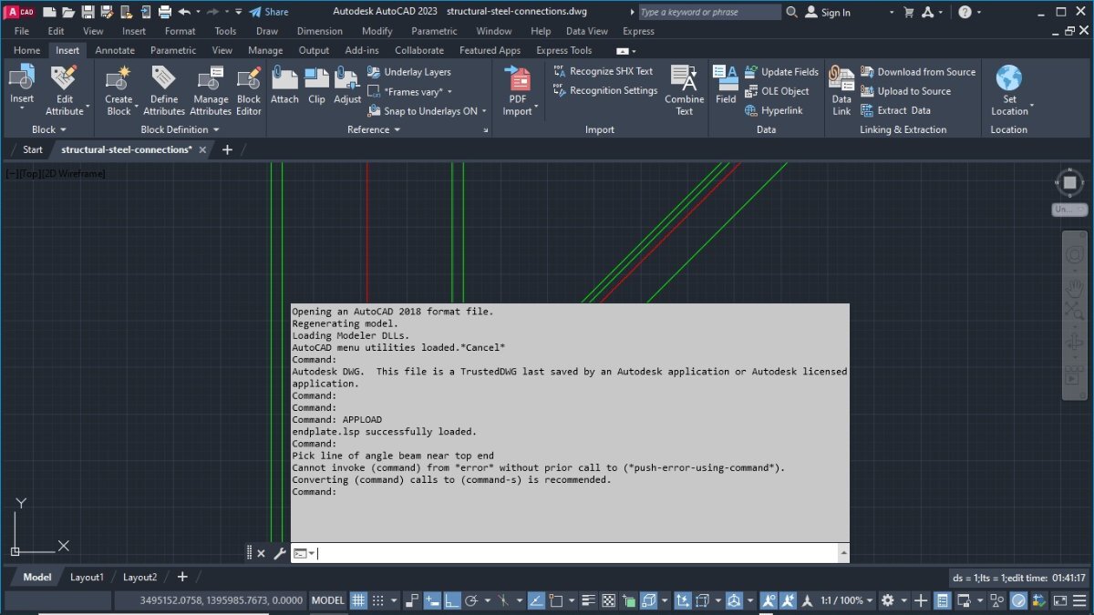

shortkrish Posted March 14 Author Share Posted March 14 hi, i am getting this error after loading both files Quote Link to comment Share on other sites More sharing options...
BIGAL Posted March 16 Share Posted March 16 Just check picking correct points, the P1 finds both ends of the beam vertical end line if you draw non 90 will screw up. Quote Link to comment Share on other sites More sharing options...
