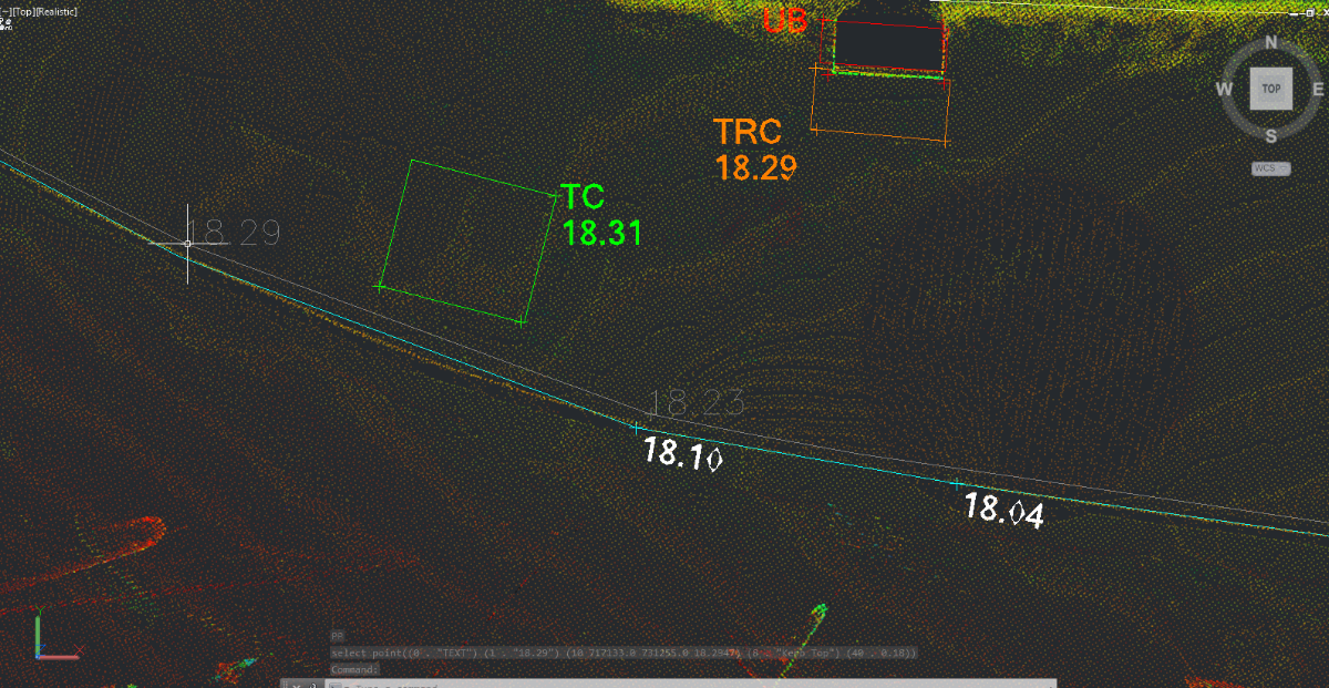

For context we are drafting a large topographic survey from a Laser Scan point cloud. We are manually drafting 3Dpolylines along road & kerb edges, bottom of walls etc. We then need to add points & elevations along the linework. I've attached an screenshot.
At the moment i'm using the LSP from @fuccaro. Which is creating a point and elevation to two decimal places when I click on a vertex. Still need to change the font style and alignment manually but it is much faster than what we were doing previously.
