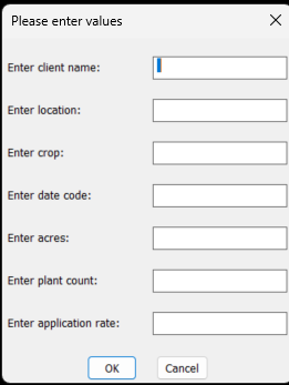

Your welcome to use multi getvals it will make a dcl on the fly for your input of values.  If make mistake can correct before hit Ok.Multi GETVALS.lsp
(if (not AH:getvalsm)(load "Multi Getvals.lsp"))
(setq lst (list "Please enter values " "Enter client name: " 20 19 " " "Enter location: " 20 19 " " "Enter crop: " 20 19 " " "Enter date code: " 20 19 " "
"Enter acres: " 20 19 " " "Enter plant count: " 20 19 " "  "Enter application rate: " 20 19 " "))
(setq ans (AH:getvalsm lst))
; ans is a list of the values you can set to a vataible or use (nth x ans) in your write line ps start at x=0

That's a great upgrade.  Works well.
I am feeling really dense, but where do I change the input box size?
I read this:
; the input box size can be bigger just change the two values tested with 145 145 and worked ok.
and cannot figure it out.
20 19 is what your looking for, I dont know why 2 values, a min max thing, as suggested in code tested with 145 144, its number of characters in the edit box.
You can make each edit box a different size like 4 3 for say 1-10 then 30 29 for a big string.
A further hint if you set a variable to say a number you can use that variable in the lst
(setq lst (list "Please enter values " "Enter client name: " 20 19 " " "Enter location: " 20 19 " " "Enter crop: " 20 19 "10" "Enter date code: " 20 19 " "
"Enter acres: " 20 19 " " "Enter plant count: " 20 19 " "  "Enter application rate: " 20 19 "20"))
(if (= apprate nil)(setq apprate 20))
"Enter acres: " 20 19 " " "Enter plant count: " 20 19 " "  "Enter application rate: " 20 19 (rtos apprate 2 0)))
