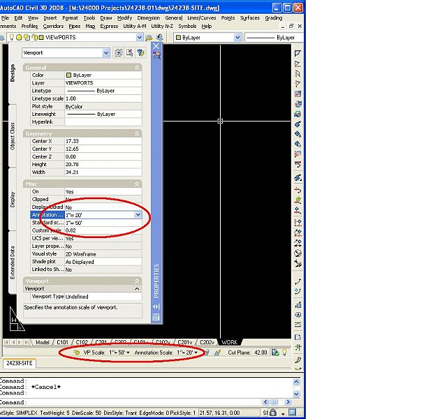

Is there a way to have my VP scale at 1"=100' and my Annotation scale at 1"=20'. I do not want my linetypes to scale to 1"=100'. They have text in it and they become to large for the look of the drawing.
Make sure your VP is unlocked, click on it. In properties you can set the scales.
You can set the Linetype scale factor for individual lines in Properties also.
  • 2 weeks later...
but they still seem to be locked together, the VP scale and the annotation scale--whether in properties palette or under the viewport, if i change one scale, it changes the other to correspond
thanks, that does the trick--the only glitch is that when you set the annotation scale, the viewport scale automatically switches to correspond, but then you can change the viewport scale afterwards without the annotation scale also changing.
