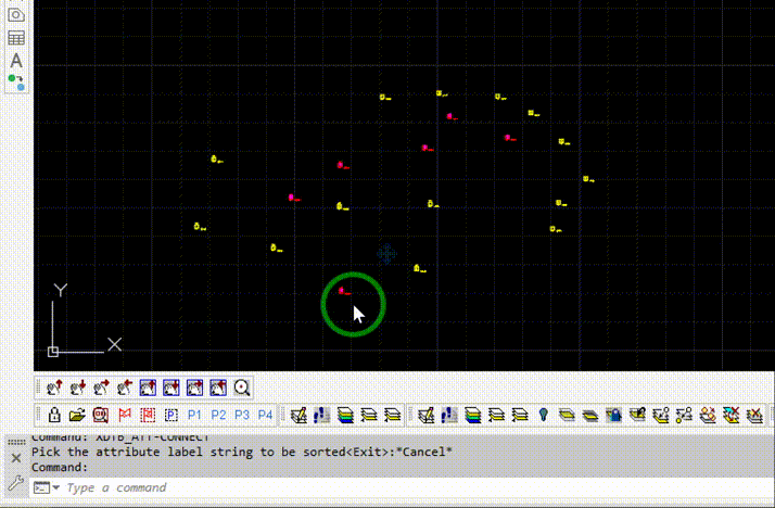

[XDrX-PlugIn(126)] Connecter attrib blocks by tag (theswamp.org)
https://www.theswamp.org/index.php?topic=59427.0

  (defun _connect-line ()
    (setq bulge 0.155)

  (if (_get-data)
      (xdrx-begin)
      (_analyze-data)
      (_connect-line)
      (xdrx-end)
