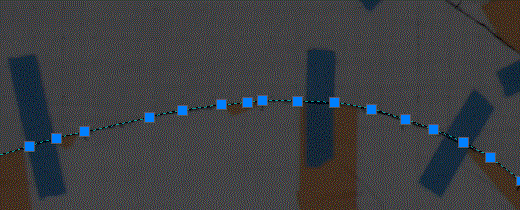

How can I disable crosshair snapping to visible nodes when simply moving close to it?
It's not snap to grid or osnap (both disabled)
I found it more annoying than useful.
Thank you.
Edited by vanowm
I don't want remove grips; I want to get rid of "magnet" that restricts movements of the crosshair.
It's disabled, I've tried disable everything that has "magnet" in the settings too.
This feature bothers me when I'm trying fine tune a spline (tracing an image), when I constantly have to zoom in and out to avoid it, loosing perspective how much a node has moved and how whole spline looks like.
