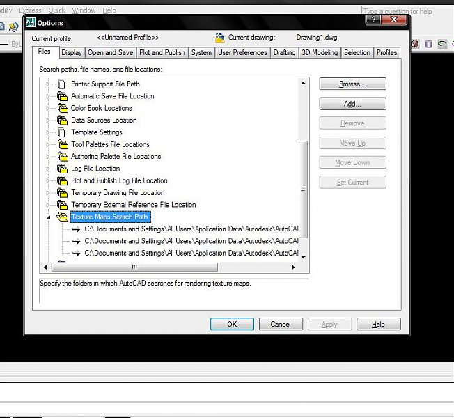

alright guys i need help. when i go to my materials, under maps-global, i click on the select image but none of my textures are there. i've been doing it like this for months and now i dont know where they are. im using autocad 2008 by the way.if you guys need more info or pics let me know. thanks
Acad 2008/9 default material library location is depend on your computer.
Can't same at all PC...Let it be...you can find with type in command line..
"options" and select file tab .Then you can see your texture map according
to my attach image.:):)
thanks alot. now i feel dumb since i was actually there but didnt know what to do since i couldnt find the folders it was showing me lol. anyways thanks alot man you made it clearer
