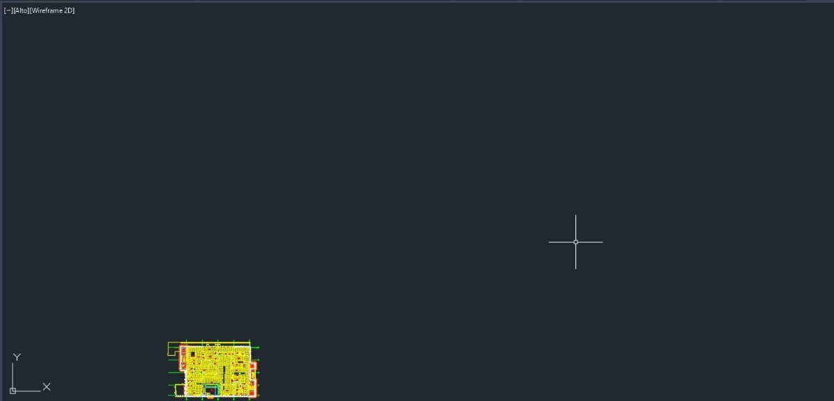

itacad Posted March 18 Share Posted March 18 Good morning, I have problems with the zoom extend of this file, I tried all the operations I knew but I didn't solve the problem, do you have any suggestions? Thank you in advance SLB1.dwg Quote Link to comment Share on other sites More sharing options...

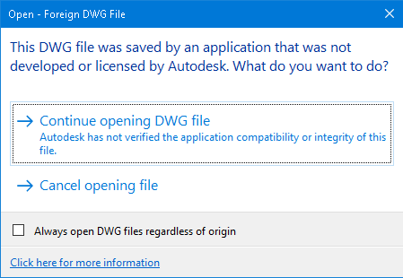

SLW210 Posted March 18 Share Posted March 18 What exactly is the issue? I get non-native DWG warning when I open it, but seems to Zoom Extents just fine for me. Quote Link to comment Share on other sites More sharing options...
itacad Posted March 18 Author Share Posted March 18 This instead is the result of my zoom extensions... Quote Link to comment Share on other sites More sharing options...
BIGAL Posted March 19 Share Posted March 19 Did you bother to do a Z E once you opened the dwg ????? The dwg was saved at whatever user zoom in view was last used. Open a dwg does not do a zoom extents. Quote Link to comment Share on other sites More sharing options...
itacad Posted March 19 Author Share Posted March 19 Yes, of course. After opening the file, if I use the zoom extensions command the view I get is the one shown, as if there was something in the top left corner Quote Link to comment Share on other sites More sharing options...

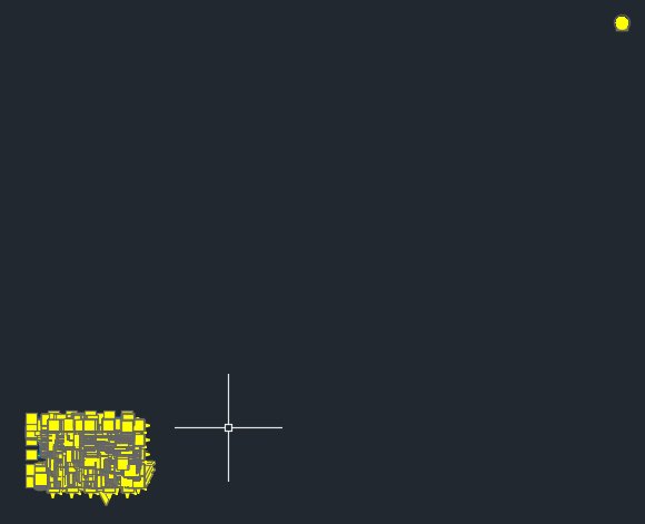

BIGAL Posted March 20 Share Posted March 20 As suggested check limits. Turn on as 1st step. : LIMITS Limits are off: Set lower left corner or [turn limits ON] <0.0000,0.0000>: Upper right corner <1408.0000,841.0000>: : id Select point to identify coordinates: X=4880.0000 Y=3580.0000 Z=0.0000 this is approx top right corner Quote Link to comment Share on other sites More sharing options...
itacad Posted March 20 Author Share Posted March 20 In the meantime, thanks... even by setting new drawing limits the result doesn't change Quote Link to comment Share on other sites More sharing options...

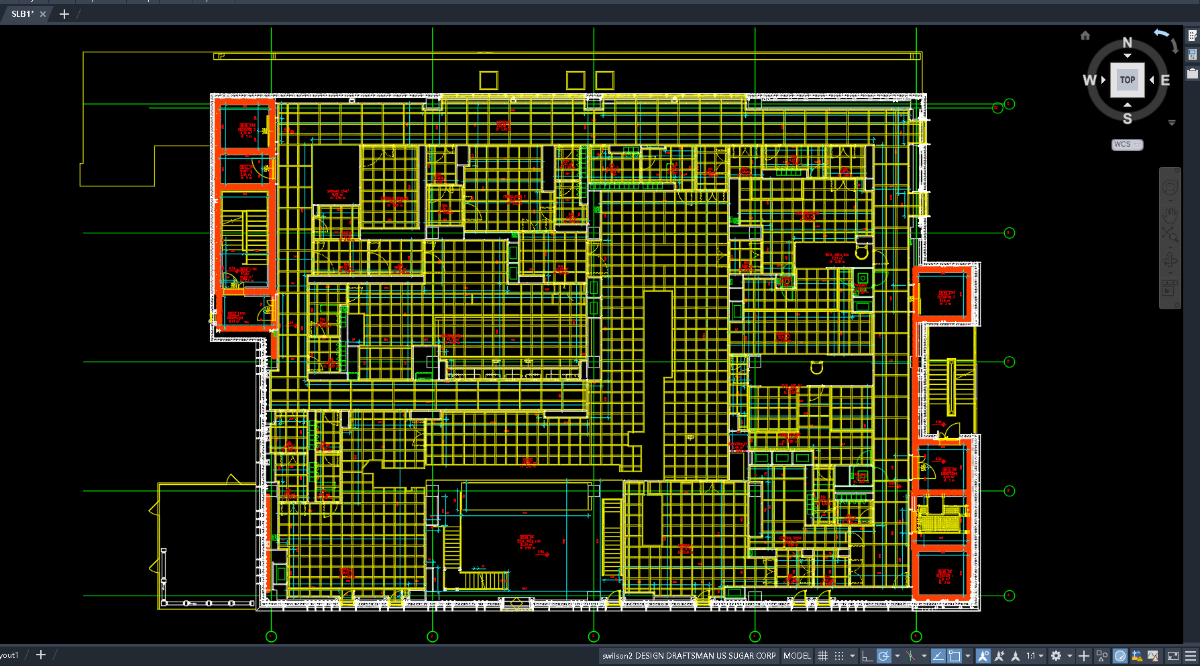

ReMark Posted March 20 Share Posted March 20 Interesting. I opened the drawing and used the MOVE command, select option (using a window), on all 31,995 objects found. As my first point I selected just to the left and below the building. As my second point I keyed in the coordinates 0,0 then saved the drawing under a new name. I closed the original, opened the newly created drawing and the building fills the entire screen. No large expanses of seemingly empty space like your first posted image. Note: when I first opened your drawing I executed the ERASE > ALL command. It reported 31,996 objects located; one more than the MOVE command found. Quote Link to comment Share on other sites More sharing options...
tombu Posted March 20 Share Posted March 20 I remember having a similar issue a few times years ago. Try zooming out just a little and selecting All. Is there a grip displayed on the right side up top? There may be a small arc with a large radius and the radius point grip is that grip or the grip point may be referenced by a block in the drawing. As I recall Zoom E had the issue but had no issue with Civil 3D's ZE command. Don't have access to AutoCAD at the moment (retired) but seemed like none of those drawings were created by AutoCAD, I believe just inserting it into a blank AutoCAD drawing would fix it. Quote Link to comment Share on other sites More sharing options...
itacad Posted March 21 Author Share Posted March 21 I found the evil entity! My problem was the number of viewable elements with grip (25,000), now I've solved it and I'm trying to eliminate it! Quote Link to comment Share on other sites More sharing options...
