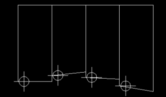

thekiki Posted March 18 Share Posted March 18 Hi, I'm looking for a lisp that can extend polygons following the polyline select. Thanks for your answers. Polyline extend.dwg Quote Link to comment Share on other sites More sharing options...
BIGAL Posted March 19 Share Posted March 19 Just some ideas get co-ords of pline sort on X&Y use a Intersect with to work out new bottom points then update pline co-ords. A little trick is can select pline near a corner and rearrange the points so start at that corner. Possibly the way I might go. Will think about it. Oh yeah people will understand CW or CCW. Quote Link to comment Share on other sites More sharing options...
thekiki Posted March 19 Author Share Posted March 19 I've found the other way to do that. First, i explode polylines and make extend to polyline. Than, i make the contour of all the polylines selected. Quote Link to comment Share on other sites More sharing options...
