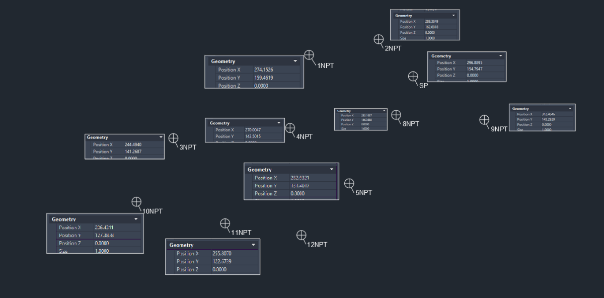

Hi! Can anyone knows or has a code on how to change position markers to point and the text will remain? Thanks in advance.

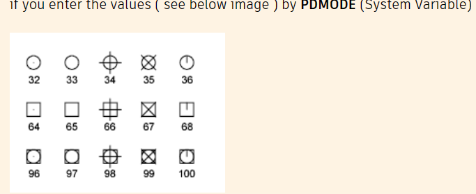

Need a dwg to see what they are, looks like Blocks not Points. Just look at properties top line. If its a block maybe be able to use Bedit to change point style, there are numbers for each style. PDMODE
Edited by BIGAL
It is not a block. It is a position marker. Here, I attach a sample for you reference. Thanks a lot
sample.dwg
Edited by vindicate
How are you making the marker a point?
AFAIK, you can only scale the size, all you have to do to keep the Text the same size is scale it up accordingly.
A bit of googling in 2017 Autodesk said can not be changed. Who knows now. Contact Autodesk support.
I think of getting the position x and y of each of the position markers and export it to csv. I used the code that was given to me before on extracting the coordinates from the position markers but I'm stuck in the "error: bad argument type: numberp: (274.153 159.462 0.0)". Can anyone help me with the code?

Yes. It came to my mind that if I've got the position x and y of the position markers, I can make a script to import all the points and there I can change the position markers into a point . I only need the position x and y hehe
I somehow exported the X and Y of the POSITION MARKER but only one x,y position will appear in the csv file like. Can anyone help me solve this code hihi please please please

The line
(setq lst (mapcar '(lambda ( x ) (list (car x) (rtos (car y))(rtos (cadr y)))) lst))
must be
(setq lst (mapcar '(lambda ( x ) (list (car x) (rtos (caadr x))(rtos (cadadr x)))) lst))
  • Thanks 1
3 minutes ago, Tsuky said:
The line
must be
WOW! Thank you! May I know what's the difference between "car" "caadr" "cadr" and "cadadr"?
