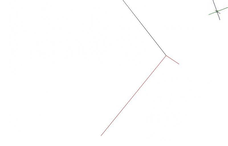

The reason loft isnt producing a very nice model is because of your curves or traces. If you zoom in to some of the corners you will see they cut back on themselves like the image below. the red line is your first red line from the bottom, the black line is something i added.

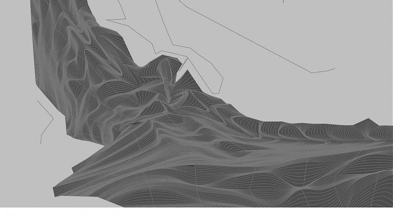

while i was waiting for something to calculate i made a partial surface from your lines. I trimmed the end of the first red line where it cut back on itself and your second to last line was actually two pieces so i couldnt use it as is. I set Surftab1 and Surftab2 = 50. This means you will have 50 divisions in your x and y (not actually x and y) direction. Depending on the resolution you want you can alter this number. surftab1 doesnt have to equal surftab2. here is a quick render with no material.
if you can do this with a loft you will actually have a lot more control over the final shape than with an edgesurf. Because the curves are so long in one direction but close in another it makes the fit a little funky. Loft will allow you to tell how it enters and exits your curve.

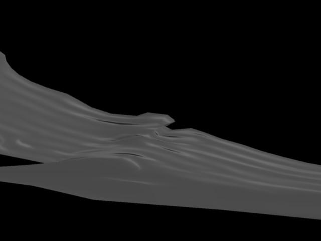

here is a good example of what the problem is. this is a loft. the issue is the number of "control points". Say you make a polyline containing 5 straight sections, then you make another one with 7 straight sections. it needs to loft and try to blend this and you get the "wave" look. Its especially bad when you have severe angles like at the "ridge" on your contours.

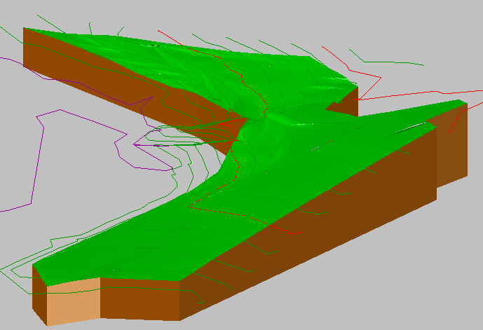

Sure you can - just need AutoCAD 2007 or later. Would take a bit of clean-up on these curves to get a good lofted surface though.
JD, how do you cut a solid with a surface in acad07+?
See the tutorials in my signature - Slice with the Surface option.
Tips 39-41 in Tutorial 1 are very much like the OP's question.
There are other examples throughout the tutorials.
interesting i have tried that before and i got an error. ill have to try it again and see what happens. Maybe I tried this in 05 and just dismissed it mentally. Thanks JD
seemed to work fine for me now with swept and lofted surfaces. Doesnt work with an edgesurf though. This may not be the place for it but can you explain why.
