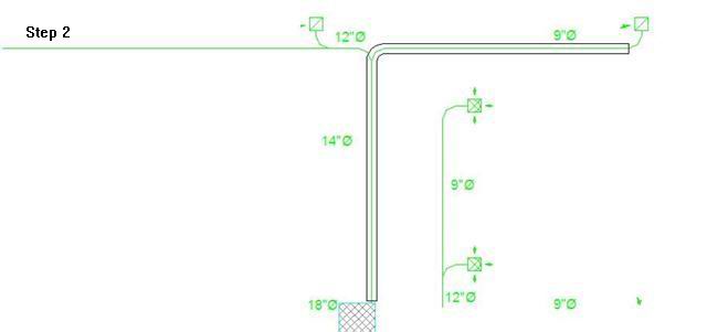

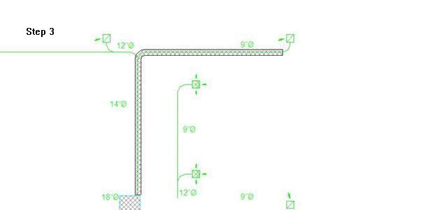

cadmando2 Posted March 5, 2009 Share Posted March 5, 2009 I'm working on a big project and to cut down on drawing I'm looking for away to create single line duct work and flex duct. I had a wpipe.lsp but how do you set i to create a single line? I tried to set it to 0 but the wpipe.lsp didn't like it. i need a to create flex duct. But I have a lot of demolition to do. what we do is offset the duct on each side of the duct and create pline so that the full lenth of the duct show two ducts one inside the other so I can hatch it to show the demo.then I remove the outside out line of the duct any idea how I can cut down on the steps to create a hatch around the duct that is being demo? here what the steps look like. Quote Link to comment Share on other sites More sharing options...
David Bethel Posted March 5, 2009 Share Posted March 5, 2009 A simple way would to be to use the MEASURE command with a BLOCK that contains a presized X line pattern on the LINE,ARC,*PLINEs of the duct run. Command: MEASURE Select object to measure: <Segment length>/Block: _B Block name to insert: DEMO Align block with object? <Y> Segment length: 1.5 -David -DEMO.DWG Quote Link to comment Share on other sites More sharing options...
