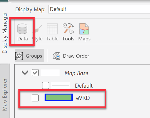

Jest Posted March 21 Share Posted March 21 Hi Is there a way to Extending Zoom only to visible objects (currently turned ON)? I have a wide sized map data connected (shp) to drawing, but turned Off. When using Zoom Extents command, invisible shp items are included and my visible objects disappeared from my sight, because they are too small. Is there a solution for this problem? Quote Link to comment Share on other sites More sharing options...

Jest Posted March 22 Author Share Posted March 22 13 hours ago, tombu said: It's simple just freeze layers rather than turning them off to avoid that issue. Objects on layers that are turned off are not only processed by Zoom Extents but slow down AutoCAD as it has to process more objects than you're actually working on. I know that...but as I said, problem causes my attached shp file...and it is turned OFF. Quote Link to comment Share on other sites More sharing options...
