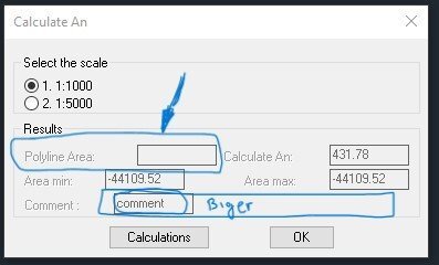

Hi, I  write this code to do some calculations. The load without erros  , select the polyline , open the dcl menu , selecti option1 or option 2 and when i press the calculation button the  dcl menu close and calculate nothing. Can anyone help me to fix this error.

I update the code but,
The load without erros  , select the polyline , open the dcl menu , select option1 or option 2 and when I press the calculation button do nothing and cannot close the  Dcl dialog. Can anyone help me to fix this error.

You know The calculation part works?  I think you need to break it out into another lisp and call it
(action_tile "Calc" "(Calc)")
Hi mhupp. I try this bit i have a
Error: syntax error
If I understand, you tell me something like .....

        (set_tile "dcl" "Calculate An")
        (action_tile "a" "(setq a $value)")
  (action_tile "Calc" "(c:Calc)")
        (start_dialog))
    (*error* nil)
(let ... ) is not a function that belongs to vanilla AutoLISP / VisualLISP...
Change it to something that belongs to some adequate function from AutoCAD AutoLISP...
Error: syntax error

Also look  at the example in the other question where I suggested the same for more help. Lines and lines and lines of code make finding errors tricky sometimes
Don't have Cad installed (just upgraded to a new PC) to look at the DCL menu but button01 and 02  should drive the calculations?

Hi mhupp. I am using ZWCAD and for the lisp code notepad++. I find some missing ) and en error in the calculation . I didi the changes but  after select the polyline I get a
Select objects: nil

The ... in the code is for you to fill out the rest of your dcl file sandwiched between (write-line "    " des)  so its incomplete until you do that.
Hi mhupp. Why you write the dcl like this?
 (write-line "test : dialog { spacer; key = \"dcl\";" des)
      (write-line " : boxed_column { label = \"Select the scale\"; height = 1.0;" des)
      (write-line "      : radio_button { height = 1.0; width = 20; is_tab_stop = true;" des)
'write-line' or 'foreach' method for creating a LISP on the fly both work. I'll also use 'write-line - I find that way can be a bit more versatile
Based off your very first post:

Thanks
The edit box for your polyline area is stored in the key "a". You haven't set that value yet using set_tile like you did with "res1", "res2", "res3" and "res4". So you need to use (set_tile "a" <your_value>) as well, in addition to the previous 4 that you have set.
As for making the edit box bigger, you can easily set the edit_width larger for that specific tile:
"    : ed { key = \"res4\"; label = \"Comment :\"; is_enabled = false; edit_width = 30; }"    ;; <--- Edit width added
Edited by Jonathan Handojo
Hi Jonathan Handojo. I did the change with the  width  and all it's ok.  I try to  (set_tile "a" <your_value>)  but I am not giving correct the polyline
                    (quote   ;; |JH| Changed to quote (Not really necessary, but just to have it look neater?)
                        (progn  ;; |JH| Changed to progn so that the QUOTE function will not run with any errors.
                            (set_tile "a" "")    ;  <---- add this
                            (set_tile "res1" "")
                            (set_tile "res2" "")
                            (set_tile "res3" "")
                            (set_tile "res4" "")
                            (setq l 0.0
                                a 0.0
                                i 0
I don't think that is correct !!!!
                                        (mode_tile "a" 2)
                                        (set_tile "a" "(setq a $value)")
                                        (set_tile "res1" (rtos (if (> t1 t3) t3 t1) 2 2))
                                        (set_tile "res2" (rtos (if (> t1 t3) t6 t5) 2 2))
                                        (set_tile "res3" (rtos (if (> t1 t3) t8 t7) 2 2))
                                        (set_tile "res4" "comment")
Thanks
$value is the value of your action tile. That action is happening as you click the "Calculation" button, so it could not have been $value.
Instead, you already have your area calculated and saved in the variable 'a' as a floating number in this point:
                                    (setq e (ssname s i)
                                        l (+ l
                                            (vlax-curve-getdistatparam e (vlax-curve-getendparam e))
                                        a (+ a (vlax-curve-getarea e))   ;; <---- This value here
                                        i (1+ i)  ;; |JH| Line added so as to not get stuck in the while loop.
So it should've been:
(set_tile "a" (rtos a 2 2))
But this is before any scaling calculations are applied, which I think (assume, cause I didn't bother with what the numbers actually show) uses your variables t1 to t8. I'll leave that to you to figure out. You've already got most of the code working fine. You just need to ensure the proper numbers are shown.
