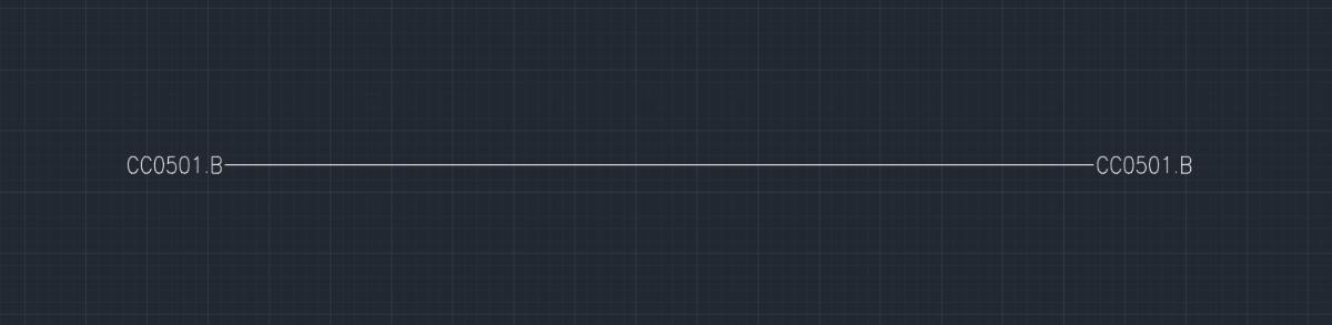

when i check the cad drawing, I want to connect texts with the same content by polyline. It wil help me check faster.
Is there any lisp that can help with that?
A couple of problems may occur is cc0501 only twice in the dwg ? If it is multiple times wrong text may join.
Yes can get a bounding box of the 2 text and draw a pline between them, that is the easy part maybe.
Before any code answer question one and supply a sample dwg with more than 1 pair of text.
I want to find the decripsion and cable no of equip.no ( The equip.no is listed). If similar texts are connected, finding the information of eqip.no  will be faster than if based on that polyline.

In the reality project has 1 equipment table and many table with the decripsion. If there was a line connecting the same contents text, it would be easier to find the descriptions of this equipment. Your lisp works very well at finding similar texts, but it would be even better if there was a straight line between the two texts. Can you help me develop Lisp?
I wrote a Lisp for you, but when I ran it on the drawing you uploaded, I got a lot of lines -mostly unwanted, I suppose.
Anyway, here is the Lisp:

I spent some more time with your drawing, here is the Lisp slightly adjusted. Now it searches only for texts that are at least 4 characters long. Also all the lines are placed on a new layer so you can delete them at once after the job is done.
(defun c:pp( / ss ss2)
  (setq ss (ssget "X" '((0 . "TEXT"))))
  (setq a8 '(8 . "ConnectLines"))
    (setq en1 (ssname ss (setq i (1- i)))
	  el1 (entget en1)
	  a1 (assoc 1 el1))
     (cond
       ((> (strlen (cdr a1)) 3)
	(setq a10 (assoc 10 el1)
	      ss2 (ssget "X" (list '(0 . "TEXT") a1)))
	(repeat (setq j (sslength ss2))
	  (setq  a11 (cons 11 (cdr (assoc 10 (entget (ssname ss2 (setq j (1- j))))))))
	  (cond ((/= a10 a11) (entmake (list '(0 . "LINE") a10 a11 a8))))
