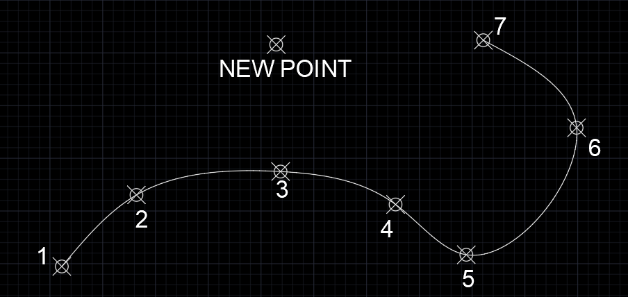

lrm Posted March 30 Share Posted March 30 (edited) Quote ...if you simply clicked between #3 and #4 wouldn't it be obvious that it's between #3 and #4 and not somewhere else? It may not be so obvious where the new point should be located with respect to the other points. For example, should the "new point" in this example be before or after point 3 or perhaps somewhere else n the sequence? Edited March 30 by lrm Quote Link to comment Share on other sites More sharing options...

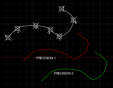

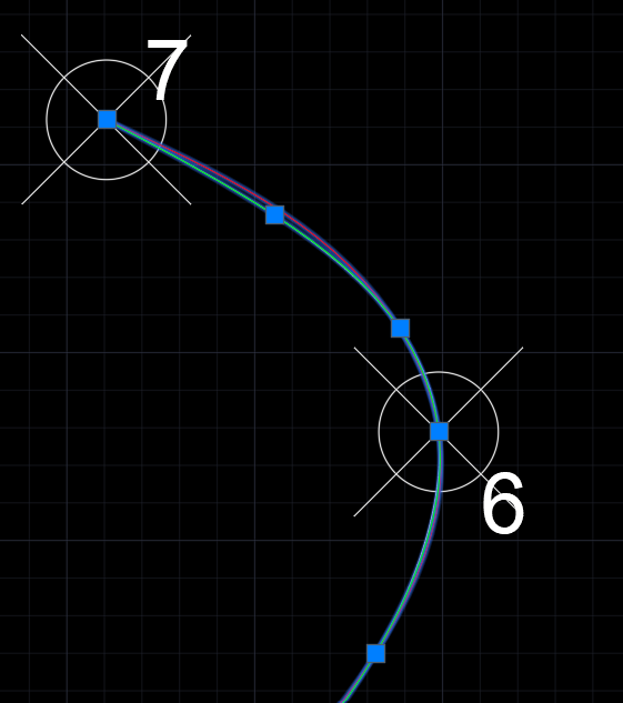

lrm Posted March 30 Share Posted March 30 It looks like Paternsmith has the limiitation that the imported spline must have fit points. Interesting. As you know, you can add fit points to an existing spline with splinedit Edit, Add and then use osnap nearest. It might be quicker to use splinedit, Polyline to convert the spline to a polyline and then create a new spline by snaping to the vertices (all or a few) of the polyline. In the image below a spline with 7 fit points was converted to a polyline with a precision of 1 (red) and precision of 2 (green). A new spline was then created from the polyline vertices. Here's a closeup of the results. Note that the red spline deviates slightly from the orginal spline. Quote Link to comment Share on other sites More sharing options...
