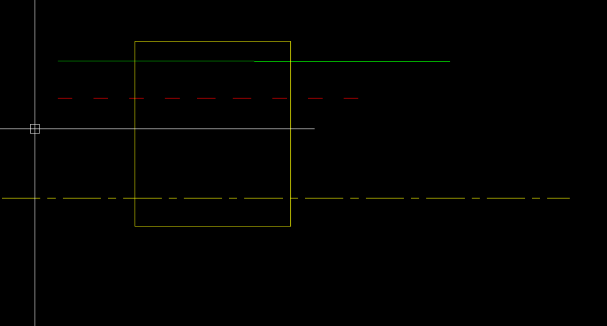

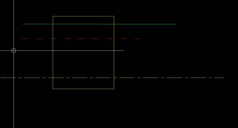

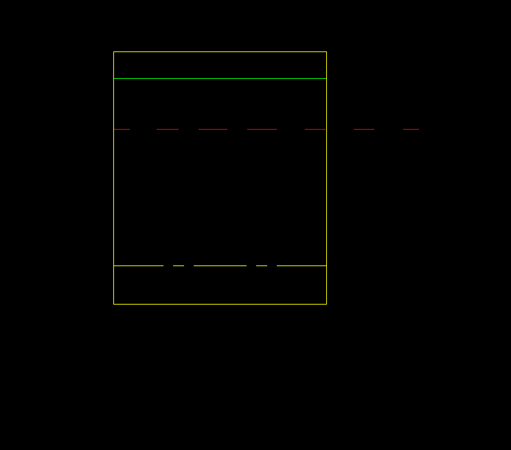

leonucadomi Posted April 2 Share Posted April 2 I use the extrim command I don't know why it doesn't cut the hidden line when the scale is large is there anything that can help? thanks for your comments Quote Link to comment Share on other sites More sharing options...
marko_ribar Posted April 2 Share Posted April 2 It's known issue... You'll have to go through workaround... Temporarily change linetype of HIDDEN line to Continous, then use EXTRIM, then apply back HIDDEN linetype to line that was errornous... Quote Link to comment Share on other sites More sharing options...
