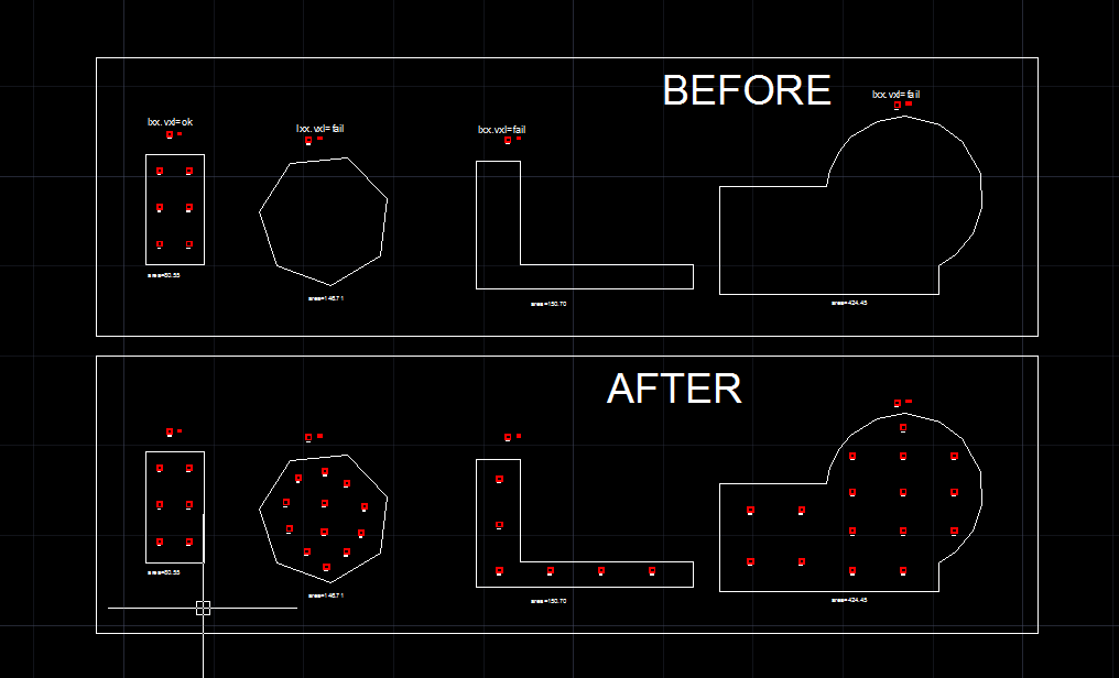

choupi1968 Posted April 9, 2024 Posted April 9, 2024 Hello, I am looking for a Lisp program that can evenly distribute (balance) a number X of blocks on a surface (area). I have several leads with existing Lisp. Can you help me ? thank. Philip https://www.cadtutor.net/forum/profile/27216-choupi1968/ Quote
devitg Posted April 9, 2024 Posted April 9, 2024 @choupi1968 It seem to be you need to NEST parts in a big part. Please upload your sample DWG before and after Quote
BIGAL Posted April 9, 2024 Posted April 9, 2024 Admin maybe merge into other post. Double posting does not mean you will get an answer sooner. Devitg dwg is in other post. Quote
mhupp Posted April 9, 2024 Posted April 9, 2024 Might be able to addapt this lisp for bpoly. keeping track of all the blocks then delete the ones that are not inside. Quote
choupi1968 Posted April 10, 2024 Author Posted April 10, 2024 17 hours ago, devitg said: @choupi1968 It seem to be you need to NEST parts in a big part. Please upload your sample DWG before and after rep-blocks.dwg bimp.lsp LXX.VLX Impl.lsp Quote
BIGAL Posted June 10, 2024 Posted June 10, 2024 Difficult task as you have implied different rules within the shapes I think its because you have done it manually. If you were to do offset of shape and insert along that could be done with multiple offsets. Look at your right hand shape. 1 Quote
