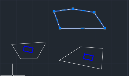

I need a Lisp Routine to find in a set of selected closed polylines, the ones that are empty inside, im using Autocad 2021,
The information of the closed polylines using the List comand on them are the following:

My test drawing its in the following image, there are 2 closed polylines with a block inside and another empty, i need to select the 3 closed polylines and after the execution of the routine, select the one empty
I need the final result something like this
You can use SSGET "WP" PTS where pts are a list of pts taken from your pline. It will return nil if nothing inside.
You need the extra point to make a closed pline.

Note if you have arcs in the pline need extra code as bulge will not be considered.
This is what you want then...
(adding the returned list to (ssget "WP"   as above)
