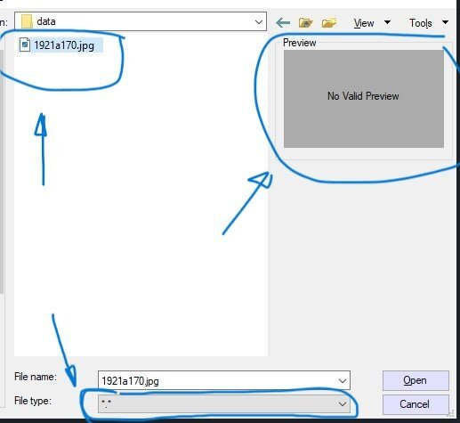

mhy3sx Posted April 11 Author Share Posted April 11 I want to ask something. Why I can not see the preview of the select image? Is something wrong with the code? (defun c:insimg ( / lst ang scale ) (if (and (setq lst (getfiled "Select Image" (getvar 'dwgprefix) "" 16)) (setq ang 0) ; Set the angle to 0 (setq scale 1) ; Set the scale to 1 ) (command "_.imageattach" lst "Specify On-Screen" scale ang) (princ) ) ) Thanks Quote Link to comment Share on other sites More sharing options...

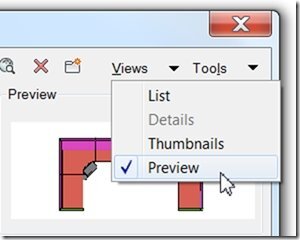

mhupp Posted April 11 Share Posted April 11 1 hour ago, mhy3sx said: Why I can not see the preview of the select image? ¯\_(ツ)_/¯ No but really does the file have/had a preview in regular windows? then it should have a preview there too. See if this is checked Quote Link to comment Share on other sites More sharing options...

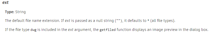

pkenewell Posted April 12 Share Posted April 12 FYI - (getfiled...) will only display a preview image when DWG is used as the extension. See link: https://help.autodesk.com/view/ACD/2024/ENU/index.html?guid=GUID-AD65DF88-5218-4655-B877-B4D33B9FB6D1 1 Quote Link to comment Share on other sites More sharing options...

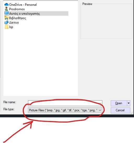

mhy3sx Posted April 12 Author Share Posted April 12 Thanks for reply. Why when I select Insert--> Raster Image the window is different and I can see in the preview the image and with the (command "_.imageattach" lst "Specify On-Screen" scale ang) I can't , isn't the same command ? Thanks Quote Link to comment Share on other sites More sharing options...
pkenewell Posted April 12 Share Posted April 12 (edited) 58 minutes ago, mhy3sx said: isn't the same command ? @mhy3sx No. the IMAGEATTACH command is built-in to AutoCAD, not AutoLISP, and it has its own file dialog that is not exposed to the AutoLISP API. Edited April 12 by pkenewell Quote Link to comment Share on other sites More sharing options...
GP_ Posted April 21 Share Posted April 21 (edited) Try this, Express Tools required (setq scale 10.0 ang 0.0) (if (setq :imm (acet-ui-getfile "Select Image" (getvar"dwgprefix") "jpg;*;png;tif;bmp" "" 288)) (command "_.-attach" :imm pause scale ang) ) Edited April 21 by GP_ 1 Quote Link to comment Share on other sites More sharing options...
