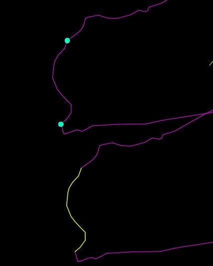

Is it possible to touch 2 or 3 points of a poly with more than 30 vertices, and have it draw a poly on top of the original poly?
duke
Hello, I'm going to explain myself.
I am attaching an image for easy reference.
The idea may be the one I give or something similar.
What I think is, touch 2 or 3 points as seen at the top of the image I attached, and that the routine will be able to create a new poly, but only from that yellow section, as shown in the part of below the attached image.
Thanks in advance for the help !!
Whipped this up real quick. but it has two problems, well I guess 3 but could be fixed easily enough. but its the weekend.
  • depending on if the polyline is clockwise or counter clockwise direction the start and end points could be reversed.
  • if the polyline has arcs would need to add a bulge function
  • if the polyline vertex 0 is inbetween points picked will draw the inverse (not the green but the purple section)
  • entsel could be a problem to in that you can select anything.

THANKSSSSSSSSSSSSSSSSSSS !!!!!
Absolutely GREAT!!!!
You deserve heaven my friend!!
Total perfection, just what I needed!!
I've got something similar that trims a polyline between points, will find it out next week
  • Like 2
Like Steven I would copy the pline say to right then trim ends, change layer etc, then move back so no problems with arcs in pline.
  • Like 2

Command: Unknown command "BREAKATPOINT".  Press F1 for help.
<Entity name: 334C7530>
What is the error?
i use Autocad 2020

--Edit
Hello friend, I have detected that when creating the new poly, at one of the 2 ends, it creates 2 points in the same place, and it does not allow me to extend the poly, so I must exploit the poly, paste it again, and so I can extend it.
Do you think that has a solution?
Thanks my friend !!
Breakatpoint might have been added as a standard comment in AutoCAD 2022 - it was an express tool before then, though there are LISPs out there going way back that do the same thing - I'll see if I can think of a simple fix
Thank you Steven!!!!
I'll look forward to it !!!
Very kind!!
Very kind!!
Try this:
