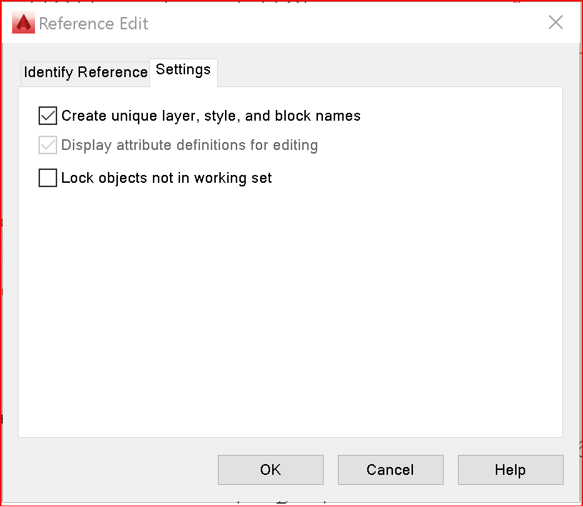

But entering editor this way it does not lock other objects (objects that are not inside block/xref).
If I use standard refedit with dialog under "settings" there is an option "lock objects not in working set". It is always checked. But how to trigger this option from lisp? I monitored sysvar changes (using reactor), but no sysvar is changed...

Have you selected LOCK OBJECTS NOT IN WORKING SET?
It does not appear to be the default value, at least in 2016.
Hello Dadgad, yes is selected.
When I first select _refedit in the context menu in a new drawing and the button ok. press then the second time everything works as desired. But you always have to edit the block the first time using the _refedit dialog box.
