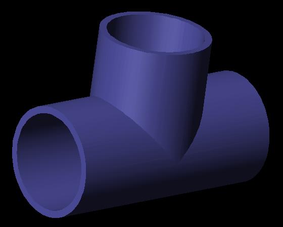

Lee Mac Posted March 13, 2009 Author Share Posted March 13, 2009 Many thanks once again Matt. I have tried the "subtract" method first, as I am not familiar with "shells", and it produces some good results I first created the outside by extruding two circles with the OD pipe diameter, then I used UNION on these. Then I did the same with the ID dimensions and just subtracted the unioned inner from the outer. simple as. Quote Link to comment Share on other sites More sharing options...

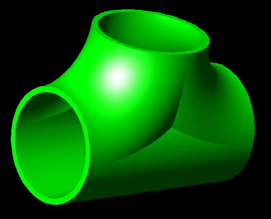

Lee Mac Posted March 13, 2009 Author Share Posted March 13, 2009 Not sure whether it looks better with Arcs or not... what dyou reckon? Quote Link to comment Share on other sites More sharing options...
shift1313 Posted March 13, 2009 Share Posted March 13, 2009 what are you trying to model? existing pipe fittings? I would take the first one and apply a fillet to the joint where the pipes meet. Quote Link to comment Share on other sites More sharing options...
Lee Mac Posted March 13, 2009 Author Share Posted March 13, 2009 what are you trying to model? existing pipe fittings? I'm just making a catalogue of pipe fittings that a user can create on the fly. Quote Link to comment Share on other sites More sharing options...
shift1313 Posted March 13, 2009 Share Posted March 13, 2009 well if you are trying to create say a Weld T you may need to smooth it out like this. the bottom one. If you are just trying to stay generic i would go with the first model(non swept arc) Quote Link to comment Share on other sites More sharing options...
Lee Mac Posted March 13, 2009 Author Share Posted March 13, 2009 Good call. Thanks once again Matt. Quote Link to comment Share on other sites More sharing options...

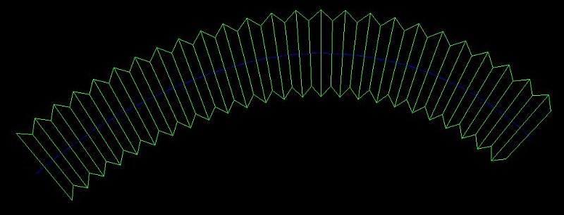

shift1313 Posted March 13, 2009 Share Posted March 13, 2009 Well, its really annoying because I have modelled: Pipes, 2D, 3D (Solid) Elbows, 2D, 3D (Solid) Caps, 2D, 3D (Solid) Concentric Reducers, 2D, 3D (Solid) Flanges, 2D, 3D (Solid) Eccentric Reducers, 2D, ... struggling with 3D.. Ducting, 2D, (3D seems impossible...). Tees, 2D, ... struggling with 3D. I have attempted to model the tees, but get stuck at this point (my 3D knowledge failing me). no problem lee. do you want to expand on the ducting you are trying to do? it may be easier than you think Quote Link to comment Share on other sites More sharing options...
Lee Mac Posted March 13, 2009 Author Share Posted March 13, 2009 I only say that the ducting seems impossible because you can't, for example, extrude a circle and change the diameter of the circle during the extrusion and equally, you can't revolve around a non-linear axis. So I was a bit stumped. Quote Link to comment Share on other sites More sharing options...
shift1313 Posted March 13, 2009 Share Posted March 13, 2009 yes that could get a bit complicated:). ill have to think about how that can be done in acad04. will the user specify the path with a pline? Quote Link to comment Share on other sites More sharing options...
Lee Mac Posted March 13, 2009 Author Share Posted March 13, 2009 Yes, the centerline is a user-specified pline. Have a play around with it yourself if you want (defun c:duct (/ *error* oVars vLst p1 p2 vEnt i PntEve PntOdd cAngE sPtE ePtE cAngO sPtO ePtO last_pt1 last_pt2) (defun *error* (msg) (if oVars (mapcar 'setvar vLst oVars)) (princ (strcat "\nError: " (strcase msg))) (princ)) (setq vLst '("CMDECHO" "CLAYER" "FILLMODE" "OSMODE" "PLINEWID") oVars (mapcar 'getvar vLst)) (setvar "CMDECHO" 0) (setvar "FILLMODE" 0) (if (not (tblsearch "LAYER" "DUCT")) (command "-layer" "M" "DUCT" "_C" "1" "DUCT" "") (setvar "CLAYER" "DUCT")) (vl-load-com) (if (and (setq p1 (getpoint "\nSpecify First Point: ") p2 (getpoint p1 "\nIndicate Direction of Duct: "))) (progn (setvar "PLINEWID" 6) (setvar "OSMODE" 0) (command "_pline" p1 (polar p1 (angle p1 p2) 2.0) "_arc") (while (> (getvar "CMDACTIVE") 0) (command pause)) (setq vEnt (vlax-ename->vla-object (entlast)) i 2.0) (while (and (setq PntEve (vlax-curve-GetPointatDist vEnt i) PntOdd (vlax-curve-GetPointatDist vEnt (setq i (1+ i))))) (setq cAngE (+ (/ pi 2) (angle '(0 0 0) (vlax-curve-getFirstDeriv vEnt (vlax-curve-GetParamAtPoint vEnt PntEve))))) (command "_line" (setq sPtE (polar PntEve cAngE 4.0)) (setq ePtE (polar PntEve (+ pi cAngE) 4.0)) "") (if (and last_pt1 last_pt2) (progn (command "_line" last_pt1 sPtE "") (command "_line" last_pt2 ePtE ""))) (setq cAngO (+ (/ pi 2) (angle '(0 0 0) (vlax-curve-getFirstDeriv vEnt (vlax-curve-GetParamAtPoint vEnt PntOdd))))) (command "_line" (setq sPtO (polar PntOdd cAngO 3.0)) (setq ePtO (polar PntOdd (+ pi cAngO) 3.0)) "") (command "_line" sPtE sPtO "") (command "_line" ePtE ePtO "") (setq last_pt1 sPtO last_pt2 ePtO) (setq i (1+ i))) (vla-put-ConstantWidth vEnt 0.0) (vla-put-Color vEnt acblue)) (princ "\n<!> Points Specified Incorrectly <!>")) (mapcar 'setvar vLst oVars) (princ)) ^^ a sample for your amusement Quote Link to comment Share on other sites More sharing options...
