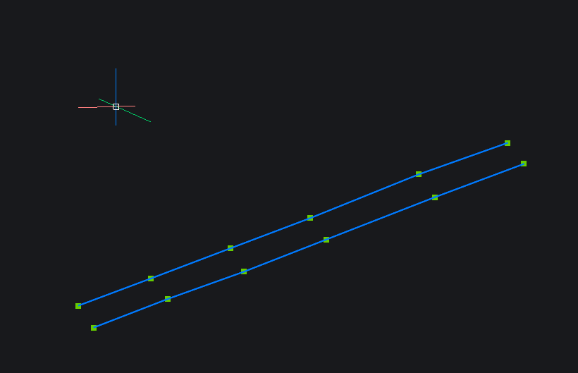

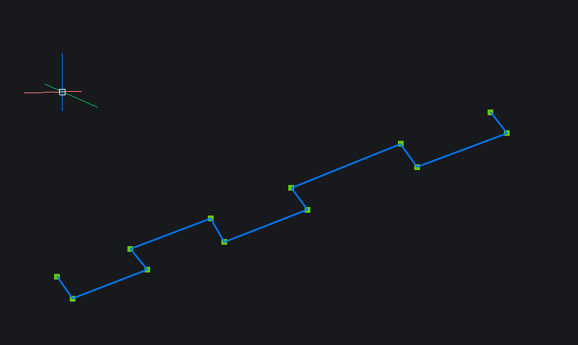

Is it possible to convert a single 3dpolyline zigzag string into two separate 3dpolylines using a lisp code?
Images attached
Thank you for help!

see Images, original 3d polyline before is a zigzag and after are two separate 3d polylines. What you don't understand?

yes mhupp it is supposed to be opposite. Zigzag is original 3d polyline and two new 3d polylines needed.
I have attached example of zigzag 3d polyline
