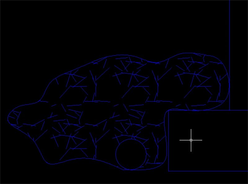

Help please my hatching is all messed up line !!
Hello
hope u all doing well..
I have a problem, would anyone please help me to fix it, i searched a little the site to see if anyone had the same problem but i couldn't find anything, i don't know if there is something in old forms i didn't check everything...
i attached a picture of my hatching, i was doing gravel, but nothing shows, just messy lines ... :cry:
thanks in advance
Set your UCS origin, or Hporigin closer to your hatch before you create it; can also be done using Hatchedit
the angle is "0" i didn't change it, the scale is 5
yessss It worked, thank you lpseifert , I did what you said, and it worked, now i can see my hatching

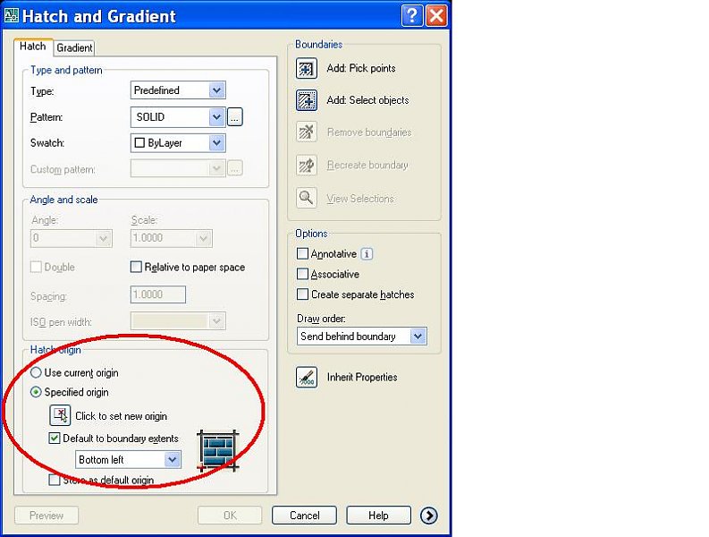

I checked the default to boundary extents box and it worked :)
Ahh sorry my suggestion was way off the mark - UCS option isn't in '04 I don't think.
