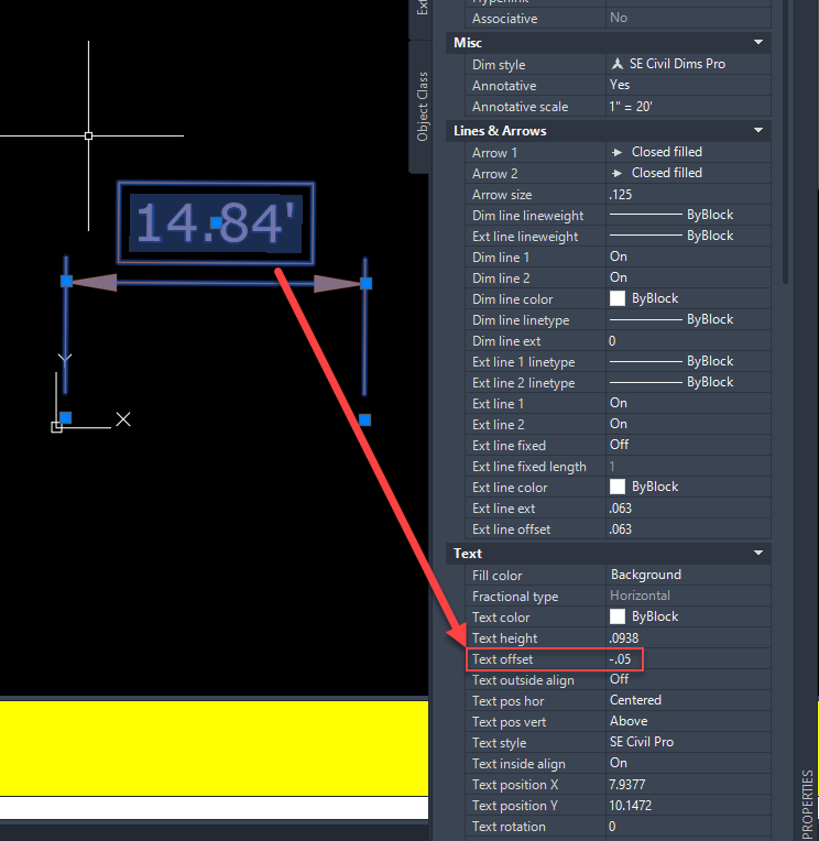

Hi Everyone!
It's been a while again.😁.  Is there any way we can remove the bounding box of an MText in a Dimension?  Above code works temporarily, but when the object is moved it goes back to its original form.
@pkenewell I'm trying to reduce the text's rectangular width of dimensions to keep the background mask highlighting only the text.
@LanloyLisp Sorry but I don't think that is possible for normal dimensions. If anything - it would require not only customizing the dimension block, but adding a reactor to the dimensions to maintain the customized elements when doing any modification to them. I'm not sure even if the reactor will work because of creating a circular reference.
If someone else is willing to attempt that challenge they are welcome to, but It's way more than I have time for.
No worries pkenewell. It seems the dimension text is constantly changing handles when edited with its own reactor. We'll see if some other CAD masters may have something to suggest.😄
In order to display the text box around dimensions someone probably added a negative sign at the front of the Text Offset in the properties palette.
If you remove the negative, the box will go away.
And if anyone wants to have a box around their dimensions.... Add a negative sign to the Text offset...

@Danielm103 I think modifying the DSTYLE xdata doesn't affect the ruler width shown above.
@troggarf Turning on and off  the text frame doesn't affect it as well.
