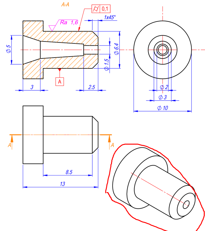

Hello, i have 3d object, and i want to put in in 2d plane at an angle to show how it looks like. I can't seem to figure out how. Could anyone help me? I am attaching my dwg drawing and a picture of how i want my 3d object to look. Thanks in advance.

Look at Vpoint command, try vpoint -1,-1,1
You would use this say in a layout in a Mview.
Have a look at your DWG with mview.
