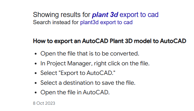

BIGAL Posted June 11, 2024 Posted June 11, 2024 Should be able to do but will get a message about proxy objects, not sure if plant3d has the option exporttocad etc which means take a plant3d dwg and export to a plain CAD dwg. Wow there is this software called Google may be try it. I don't have Plant3d so not tested. 1 Quote
tricon77 Posted June 12, 2024 Author Posted June 12, 2024 Thanks for the info. Looks like the guarantee way is to export it. I forgot about that method. Thanks, Michael Quote
