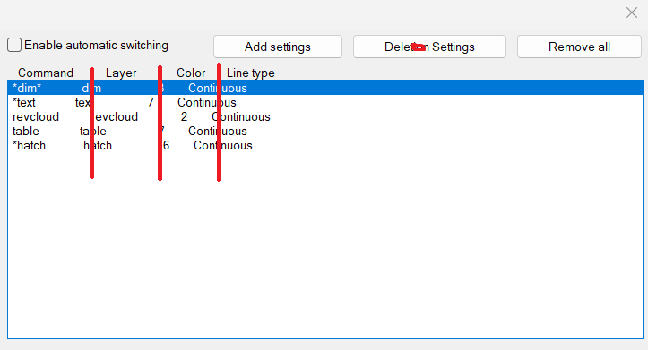

How to Align text in DCL
rdx
DEAR ALL
;;;Temporary dialog box

I tended to learn from AfraLISP  - SLW210 link.
For alignment you might want to consider a combination of row and column codes with a width setting.
This is for an example, taken from a grid DCL: an image, under that and lined up a text description, 'next' row is the same again (is actually row 3 because of the text description).
  (write-line "    :boxed_column { width = 25; alignment = top;" fo)
  (write-line "      :row {alignment = top;" fo)
  (write-line "        :column {width = 15; :image_button {key = Im0; width = 9; height = 5; color = dialog_background; allow_accept = true; alignment = centered;}}" fo)
  (write-line "        :column {width = 15; :image_button {key = Im1; width = 10; height = 7; color = dialog_background; allow_accept = true;}}" fo)
  (write-line "      }" fo) ; end row
  (write-line "        :column {width = 15; :text { key = \"Txt0\"; label = \"Func.\"; width = 9;}}" fo)
  (write-line "        :column {width = 15; :text { key = \"Txt1\"; label = \"Func.\"; width = 9;}}" fo)
  (write-line "        :column {width = 15; :image_button {key = Im4; width = 10; height = 7; color = dialog_background; allow_accept = true;}}" fo)
  (write-line "        :column {width = 15; :image_button {key = Im5; width = 10; height = 7; color = dialog_background; allow_accept = true;}}" fo)
  (write-line "        :column {width = 15; :text { key = \"Txt4\"; label = \"Func.\"; width = 9;}}" fo)
  (write-line "        :column {width = 15; :text { key = \"Txt5\"; label = \"Func.\"; width = 9;}}" fo)
  (write-line "    }" fo) ; end boxed column
In yours perhaps the 'command layer colour linetype' should also be split into 4 columns in a single row
It all becomes mental fun when you want columns and rows spanning multiple other rows and columns to get it all lining up.

If the goal is making a DWT "export Template" why would you need to keep changing ? Would it not be just as easy to make a script file and edit that ?
In  a package we had correct layer linetype and color based on draw an object like a wall or a door etc, behind it was a text file with all the settings 91 different layers. The reason I mention it is that you must still be ridged in setting correct layer so we use menu options to force this. In this house every layer is correct as the set layer has been taken away from the end user. Of course you can still not use the inbuilt functions and draw on wrong layers but no automation.
For a recent client request, Text and Dims are in a menu so all objects drawn are to company standards.
You could possibly do a reactor check for "HATCH" and set layer but don't have that code.
  • Like 2

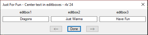

slightly off topic , it irritated me edit boxes are only left aligned so just for fun (app doesn't actually  do anything) :
;;; just for fun , center texts in editboxes - rlx jun'24
(defun c:jff ( / center-factor )
  (create_dialog)
;;;| Just For Fun - Center text in editboxes - rlx jun-2024                |
;;;|        editbox1                editbox2               editbox3        |
;;;|                       [ <-- ] [ done ] [ --> ]                        |
;;; dcl_jff input : m = message , l = label list , v = (default) values list
;;; (dcl_jff "Just For Fun - Center text in editboxes - rlx'24"
;;; '("editbox1" "editbox2" "editbox3") '("Dragons" "just wanna" "have fun"))
(defun dcl_jff (m l v / f p d r)
  (and
    (setq p (open (setq f (vl-filename-mktemp ".dcl")) "w"))
    (write-line (strcat "dcl_jff:dialog {label=\"" m "\";:row {") p)
    (write-line (strcat ":column {children_alignment=centered;:text {label=\"" (nth 0 l)
                        "\";}:edit_box {edit_width=24;key=\"eb1\";}}") p)
    (write-line (strcat ":column {children_alignment=centered;:text {label=\"" (nth 1 l)
                        "\";}:edit_box {edit_width=24;key=\"eb2\";}}") p)
    (write-line (strcat ":column {children_alignment=centered;:text {label=\"" (nth 2 l)
                        "\";}:edit_box {edit_width=24;key=\"eb3\";}}}spacer;") p)
    (write-line (strcat ":concatenation {alignment=centered;"
                        ":button {key=\"bt1\";label=\"" (nth 3 l) "\";} spacer;"
                        ":button {is_default=true;key=\"bt2\";label=\"" (nth 4 l) "\";}spacer;"
                        ":button {key=\"bt3\";label=\"" (nth 5 l) "\";}}}") p)
    (not (setq p (close p))) (< 0 (setq d (load_dialog f))) (new_dialog "dcl_jff" d)
    (mapcar '(lambda (x y)(set_tile x y)) '("eb1" "eb2" "eb3") v)
    (CenterEditboxStrings)
    (action_tile "bt1" "(Update_Edit_Box_Center_Factor 1)")
    (action_tile "bt2" "(setq r (list (get_tile \"eb1\")(get_tile \"eb2\")(get_tile \"eb3\")))(done_dialog 1)")
    (action_tile "bt3" "(Update_Edit_Box_Center_Factor 0)")
    (start_dialog)(unload_dialog d)  (vl-file-delete f)
  (create_dialog)
  (and
  r
(defun Update_Edit_Box_Center_Factor ( i / f )
  (if (null Center-Factor) (setq f 6) (setq f Center-Factor))
  (cond ((= i 1) (setq f (1+ f)))((= i 0) (setq f (1- f)))(t (setq f 1)))
  (if (< f 1)(setq f 1))
  (setq Center-Factor f)
(defun create_dialog ()
  (alert
    (vl-princ-to-string
      (dcl_jff
        '("editbox1" "editbox2" "editbox3" " <--- " "Done" " ---> ")
        '("Dragons" "Just Wanna" "Have Fun")
(defun CenTileText ($k / v x l) (if (null center-factor)(setq center-factor 6))
  (setq v (vl-string-trim " " (get_tile $k)) l (strlen v) x (fix (/ (dimx_tile $k) center-factor)))
    (if (< l x) (repeat (- x l)(setq v (strcat " " v)))) (set_tile $k v))
(defun CenterEditboxStrings ( / tl ) (setq tl '("eb1" "eb2" "eb3")) (foreach tile tl (CenTileText tile)))
(c:jff)
dear sir
thanks
