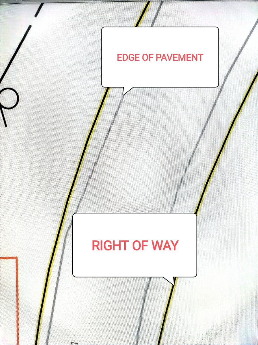

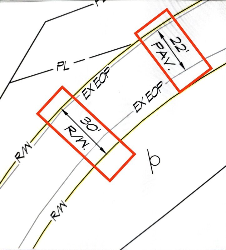

I'm looking for a tool that can automatically place dimensions in a specific, standard style on selected layers.
Here's a specific scenario:
I have two layers: one for the "Edge of Pavement" and another for the "Right of Way" of a road. When I run the tool, it should prompt me to choose the layers where these dimensions will be placed.

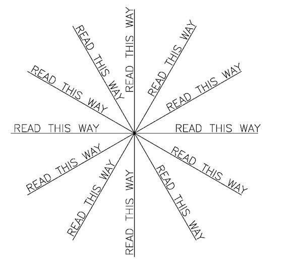

After selecting the layers, the tool should automatically generate two aligned dimensions that are easy to read and understand. These dimensions should be oriented in the direction of the road itself.
Note: i've added example below, I request all to pls go thorough for better understanding.
Can anyone help me with this?

Form a coding point of view pick a point on 1st say pline pick second pline draw dim. yes needs some extra like what descriptions to add as 2nd line. Please advise and can do something for choices.
(defun c:wow ( / pt1 pt2 pt3 obj obj2)
(setvar 'osmode 0)
(while (setq ent (entsel "\nPick 1st object Nothing to exit "))
 (setq pt (cadr ent))
 (setq obj (vlax-ename->vla-object (car ent)))
 (setq pt1 (vlax-curve-getclosestpointto obj pt))
 (setq obj2 (vlax-ename->vla-object (car (entsel "\nSelect 2nd object "))))
 (setq pt2 (vlax-curve-getclosestpointto obj2 pt1))
 (command "dim" "aligned" pt1 pt2 pt1 "" "")
(setvar 'osmode oldsnap)
(c:wow)
