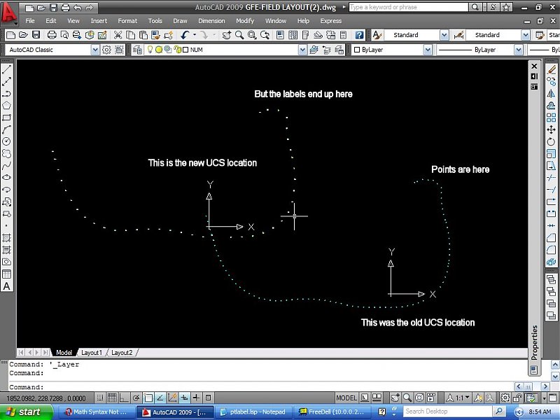

Bill Tillman Posted March 21, 2009 Author Share Posted March 21, 2009 Thanks Carl. That got me going again after stalling last night. But this morning I tried it on a new and much larger set of points. It worked great but then the surveyor called and said they cannot use the origin point we started with. So I simply moved the UCS to the new origin he wanted. But then when I ran the LISP routine it apparently does not get the complete message about the new UCS orientation and does not plot the labels near the points. Instead it plots them in the same orientation, relative to the new UCS origin which means they are way off base from the point locations. Is there something I'm missing on moving the UCS? Quote Link to comment Share on other sites More sharing options...

CarlB Posted March 21, 2009 Share Posted March 21, 2009 The progrm queries the point and obtains its *world* coordintes no matter the UCS. You want UCS cordinate values to be reported, and text placed at UCS coordinates. Which calls for a coordinate transformation. After the line: (Setq p1 (cdr (assoc 10 (entget (ssname mysset counter))))) add this line; (setq p1 (trans p1 0 1));translate from world to UCS Quote Link to comment Share on other sites More sharing options...

Bill Tillman Posted March 22, 2009 Author Share Posted March 22, 2009 Dude, that is awesome. The other script was great but with the drawing I was using which had only 80 points in it, there would be a noticeable delay between the time I pressed enter and the time it finished. This script finished faster than I could pull my finger off the enter key. I will study this one in depth. The only thing I see is that the trans function is not working because when I moved the UCS I got the same trouble as before, the labels printed off somewhere besides the points unless I set the WCS. The real trick with what I'm trying to do is to down and dirty be able to give the surveyors accurate point data no matter where they setup. And with this job, the surveyors keep changing their minds on where they want to setup. I can't blame them as this site has lots of existing structures and obstacles to deal with. Thanks again and I'm really learning alot from you guys. Quote Link to comment Share on other sites More sharing options...
CarlB Posted March 22, 2009 Share Posted March 22, 2009 Lee's routine uses 'entmake' to place the text, the text is placed at World coordinates. (the previous method used the (command "text" etc...) which places text at UCS coordinates. So 'trans should not be used on the coordinates for the 'entmake' text placement. For determining the x/y values, the coordinates do need to be transformed. Quote Link to comment Share on other sites More sharing options...
Bill Tillman Posted March 22, 2009 Author Share Posted March 22, 2009 If I'm not mistaken, line #27 of Lee's code does use the trans function: (foreach pt (mapcar '(lambda (x) (trans (cdr (assoc 10 (entget x))) 0 1)) But this program will only plot the labels at the WCS coordinates. I'm hacking at this again this morning to get it working like the other which will plot to whatever the current UCS is at. Any advice would be appreciated. Quote Link to comment Share on other sites More sharing options...
Lee Mac Posted March 22, 2009 Share Posted March 22, 2009 I really hate working with UCS and WCS... a pet peeve of mine I think.. But going on Carl's knowledge of such things, would this suffice? (defun c:ptlabel (/ *error* ovar vlst ss i temp UCSpt xtxt ytxt ztxt) (vl-load-com) (defun *error* (msg) (if ovar (mapcar 'setvar vlst ovar)) (princ (strcat "\n<!> Error: " (strcase msg) " <!>")) (princ)) (setq vlst '("CMDECHO" "CLAYER" "OSMODE") ovar (mapcar 'getvar vlst)) (mapcar 'setvar vlst '(0 "0" 0)) (foreach x '("NORTH" "EAST" "NUM" "Z") (if (tblsearch "Layer" x) (command "._layer" "_thaw" x "unlock" x "_set" x "") (command "._layer" "_make" x "_color" "7" x ""))) (prompt "\nSelect Points: ") (if (setq ss (ssget '((0 . "POINT")))) (progn (setq i 1) (or sch (setq sch 1.0)) (initget 6) (setq temp (getreal (strcat "\nEnter Scale <" (rtos sch 2 2) ">: "))) (or (not temp) (setq sch temp)) (foreach pt (mapcar '(lambda (x) (cdr (assoc 10 (entget x)))) (vl-remove-if 'listp (mapcar 'cadr (ssnamex ss)))) (setq UCSpt (trans pt 0 1) xtxt (strcat "E " (rtos (/ (car UCSpt) 12) 2 4)) ytxt (strcat "N " (rtos (/ (cadr UCSpt) 12) 2 4)) ztxt (strcat "Z " (rtos (/ (caddr UCSpt) 12) 2 4))) (Make_Text pt (rtos i 2 0) 40 "NUM") (Make_Text (polar pt (/ (* 3 pi) 2) (* sch 3.0)) ytxt 3 "NORTH") (Make_Text (polar pt (/ (* 3 pi) 2) (* sch 6.0)) xtxt 7 "EAST") (Make_Text (polar pt (/ (* 3 pi) 2) (* sch 9.0)) ztxt 1 "Z") (setq i (1+ i)))) (princ "\n<!> No Points Selected <!>")) (mapcar 'setvar vlst ovar) (princ)) (defun Make_Text (pt val col lay) (entmake (list '(0 . "TEXT") (cons 8 lay) (cons 10 pt) (cons 40 (* sch 2.5)) (cons 1 val) '(50 . 0.0) (cons 7 (getvar "TEXTSTYLE")) (cons 62 col) '(71 . 0) '(72 . 1) '(73 . 2) (cons 11 pt)))) Quote Link to comment Share on other sites More sharing options...
