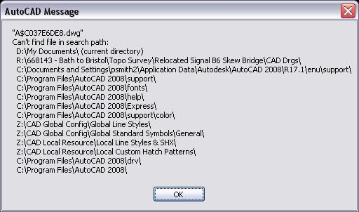

skipsophrenic Posted March 23, 2009 Share Posted March 23, 2009 As the title sugests. Quote Link to comment Share on other sites More sharing options...
Tiger Posted March 23, 2009 Share Posted March 23, 2009 Err....re-start the computer? Sounds like AutoCAD can't read the drives... Quote Link to comment Share on other sites More sharing options...
skipsophrenic Posted March 23, 2009 Author Share Posted March 23, 2009 I've sorted it out now - don't know how though it happened while i was using the LEAD command if it helps? Quote Link to comment Share on other sites More sharing options...
Tiger Posted March 23, 2009 Share Posted March 23, 2009 I have gotten the same kind of message once in a while - but it did not complain about not being able to read C:/ but my networks drivers beacuse the comp had not managed to map them correctly. Sorry I can't help you Skipso, glad it got sorted though Quote Link to comment Share on other sites More sharing options...
lpseifert Posted March 23, 2009 Share Posted March 23, 2009 Looks like the leader command was trying to insert a block (A$C...) that it couldn't find. Quote Link to comment Share on other sites More sharing options...
Tiger Posted March 23, 2009 Share Posted March 23, 2009 oh right - that's what it's saying! And that's a typical block-name for a copy-paste-block right? How have that ended up in a Leader? Quote Link to comment Share on other sites More sharing options...
lpseifert Posted March 23, 2009 Share Posted March 23, 2009 Electrons gone wild maybe? Quote Link to comment Share on other sites More sharing options...
skipsophrenic Posted March 23, 2009 Author Share Posted March 23, 2009 All in all i think it's safe to say "somewhat odd" Quote Link to comment Share on other sites More sharing options...
Tankman Posted March 23, 2009 Share Posted March 23, 2009 Looks like the leader command was trying to insert a block (A$C...) that it couldn't find. AutoCAD did indeed search, looks like all over the place and couldn't find the block. I don't use blocks often however I save all blocks in a file "Blocks" which is added to the search locations in tools, support file search path. Quote Link to comment Share on other sites More sharing options...
