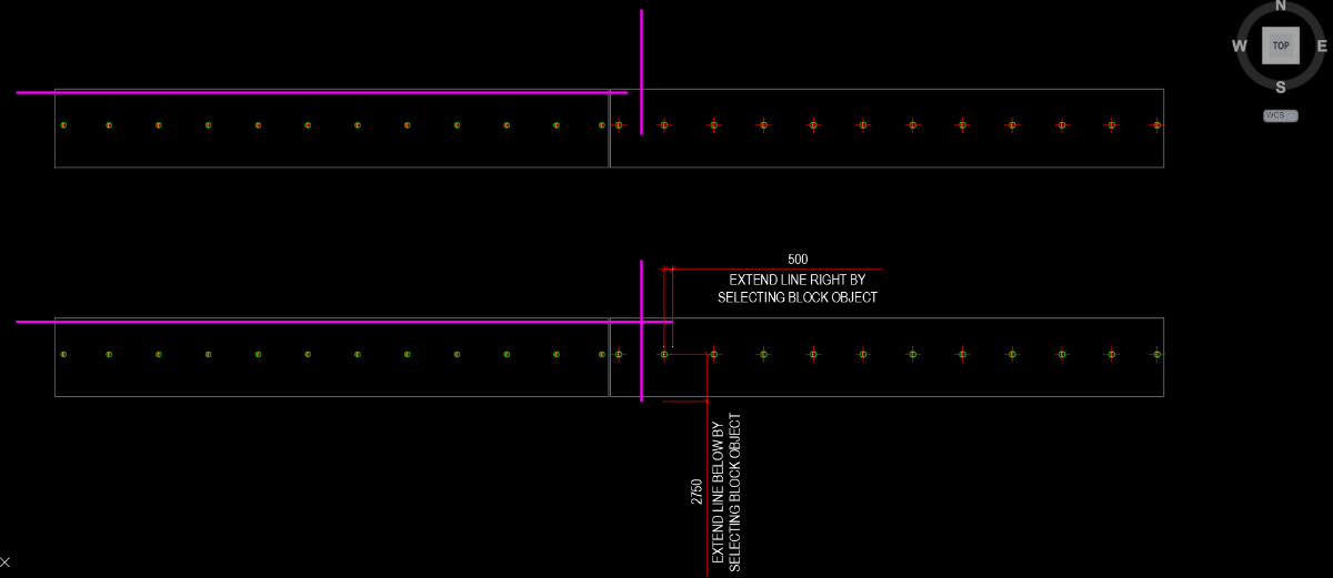

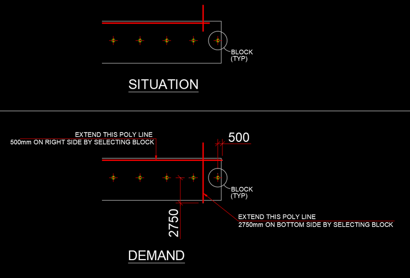

BIGAL Posted August 9, 2024 Posted August 9, 2024 This seems to work but only for the scenario provided, needs a extra check for direction is left/right. Will need some more work, think of it as proof of concept. Â When asked to pick a line, pick near end to move. ; https://www.cadtutor.net/forum/topic/89269-extend-polyline-up-to-specific-distance-by-selecting-specific-block/ ; By AlanH Aug 2024 (if (not AH:getvalsm)(load "Multi Getvals.lsp")) (setq ans (AH:getvalsm (list "Enter values " "Hor offset " 5 4 "500" "Ver offset " 5 4 "1200" ))) (setq h (atof ( car ans)) v (atof (cadr ans))) (setq obj1 (vlax-ename->vla-object (car (entsel "\nSelect a block ")))) (setq pt (vlax-get obj1 'insertionpoint)) (setq ptx (car pt) pty (cadr pt)) (setq ent (entsel "\nSelect Horizontal line ")) (setq obj2 (vlax-ename->vla-object (car ent))) (setq start (vlax-curve-getstartPoint obj2)) (setq end (vlax-curve-getEndPoint obj2)) (setq pt3 (cadr ent)) (setq d1 (distance pt3 end)) (setq d2 (distance pt3 start)) (if (< d1 d2) (setq swap "yes") ) (setq pt2 (list (+ h ptx) (cadr end))) (if (= swap "yes") (vlax-put obj2 'endpoint pt2) (vlax-put obj2 'startpoint pt2) ) (setq ent (entsel "\nSelect Vertical line ")) (setq obj2 (vlax-ename->vla-object (car ent))) (setq start (vlax-curve-getstartPoint obj2)) (setq end (vlax-curve-getEndPoint obj2)) (setq pt3 (cadr ent)) (setq d1 (distance pt3 end)) (setq d2 (distance pt3 start)) (if (< d1 d2) (setq swap "yes") ) (setq pt2 (list (car end)(- pty v))) (if (= swap "yes") (vlax-put obj2 'endpoint pt2) (vlax-put obj2 'startpoint pt2) ) Â Added to my to do list to take into account directions. Multi GETVALS.lsp Quote
rpsalvi Posted August 9, 2024 Author Posted August 9, 2024 actually this circle is pile and i want to extend poly line 500 mm on right and left side of pile & 2750 mm in bottom side of pile Quote
BIGAL Posted August 9, 2024 Posted August 9, 2024 I did what you showed in image, not sure about "500 mm on right and left side of pile" please post another image or dwg, zoom in a bit please for image. Quote

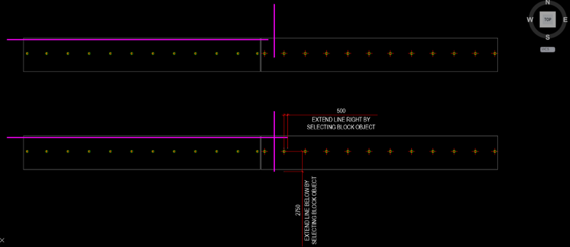

rpsalvi Posted August 13, 2024 Author Posted August 13, 2024 PLEASE FIND HERE WITH ATTACHED CAD FILE FOR MY ISSUE SAMPLE.dwg Quote
BIGAL Posted August 14, 2024 Posted August 14, 2024 Again I did what you showed in image  Just save multi getvals in support path or add full path to (Load "Multi getvals")  Quote
