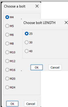

DYNAMIC BOLT.dwgThere are some lisp dclsamples out there that do what you want select a bolt dia and a Child dcl pops with the sizes.
Something like this. Size is chosen. This is a Child dcl. It can have children also I believe.
In a simpler way you can use Multi radio buttons it chooses the next radio button dcl to display. You dont need to worry about the dcl coding, its handled for you.
An example, just make sure you save Multi radio button.lsp in a support directory.
(DEFUN C;WOWTEST ( / ANS LEN )
(if (not AH:Butts)(load "Multi Radio buttons.lsp"))
(if (= but nil)(setq but 1))
(setq ans (ah:butts but "V" '("Choose a bolt" "M4" "M5" "M6" "M8" "M10" "M12" "M16" "M20" "M24"))) ; ans holds the button picked
(SETQ M4 (list "Choose bolt LENGTH " "25" "30" "40"))
; M6
; M8
(COND
((= ANS "M4")(SETQ LEN M4)
; m6 m8 etc
(setq LENGTH  (ATOI (ah:butts 1 "V" LEN))))
(PRINC)
Something like this as a result.
RLX is great at dcl's he may answer, I will look at adding a new multi radio buttons version that has a child dcl option so all occurs in one dcl like top image.
Lastly pretty sure have seen bolts, screws, capheads, allen, fastners and so on in a dcl and does what you want and a lot more. Sorry can not provide any more info need to google.
Ps here is a bolt as well.
Multi radio buttons.lsp Multi radio buttons.lsp

i like the button option but there are for some bolts to much lenght. A listbox is better to use.

Ok you can use a cond after getting bolt dia, to set the blst and this will pop a list.
(if (not AHlstbox)(load "Listbox-AH.lsp"))
(setq blst (list  "35" "40" "45" "50" "55" "60" "65" "70" "75" "80" "90" "100" "110" "120" "140" "150" "160" "180" "200" ))
(setq blen (nth (ahlstbox "Pick a number" blst  20 10) blst))
Listbox-AH.lsp

On 8/24/2024 at 8:03 PM, rlx said:
niet compleet maar probeer deze maar eens...
;;; This program demonstrates how to update a secondary list_box based on user selection from a primary list_box.

  (create_bout_dialog) is twice in this lisp. do i have to repalce it with your   (create_bout_dialog)?
the code in the first part is just to show where you went wrong (lst1 is not a list but the key name of your listbox). That's why it always returns nil.
The attached lisp file is all you need. You still have to implement the other sizes but it's a start for you to built on further.
instead of creating a cond function for all combinations I used something like :
((eq model "M4")(setq WTBSYB (strcat "DIN931-A0M04x" (3ZFill make) "E")) (WTBSB))
Model "M4" = "DIN931-A0M04x" + make "E" but make is "25" so I use 3ZFill (3 Zero Fill) to turn it into "025" so symbol name becomes : "DIN931-A0M04x025E"
Maybe "M5" = "DIN931-A0M05x" + make + "E" and "M6" = "DIN931-A0M06x" + make + "E" etc. This saves you a lot of extra code
good luck!

Hi RLX, you helped my a lot with your adjustments to the lisp file. There is only one problem. When i use M5-70 or M6-70 or M16- 100; i get an error code: Bad argument type: consp nil. All the compositions work except for the second list above the 8th choice. than i get the error. The list is to long.
regards, patrick
bout.lsp
can't fully test app without the blocks but try it now.
Only changed a few variable names so maybe working of program is a little clearer.
Also added a few extra princs for debug info. Those can be removed once app runs as expected.
